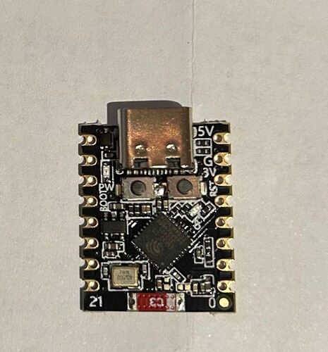

I’ve purchased two ESP32 C3-Minis from Amazon but cannot install ESP Home on either of them using ESPHome web from within ESPHome add in.

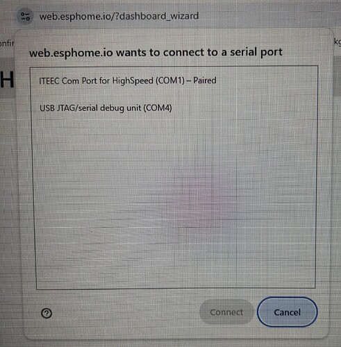

When I connect it to usb It keeps connecting and disconnecting but when you look at the serial connection options its Com 4 the JTAG debug connection that keeps disconnecting. The ITEEC com port on COM 1 remains connected.
If I choose Com1 and try and install it says its connected but then fails each time. According to the instructions that come with the board here for flashing for the first time it says I need to put the board into download mode manually this is done by holding down the Boot button, clicking the reset button once and then releasing the boot button. I have tried all variations of holding down the buttons both while connected and while plugging in the USB. By following these instruction Com4 remains connected but I still cannot flash the device. I’ve tried holding down the reset button for 2 seconds as suggested by @Piter123 Piter123Piotr in a similar thread, but that makes no difference

Just came across this article this morning, not sure, if it applies to your devices, though:
Be Wary Of Flash-less ESP32-C3 Super Mini Boards | Hackaday

OK so I have made some progress. I found on another thread that using ESP tools heled someone and sure enough ESP tools found and configured one of my Superminis. All I had to do then was to adopt it into Home Assistant. Fortunately ESP Tools showed it had 4mb flash so not one of those described in Hackaday.

For anyone finding this thread in the future. The problem I initially had was using the wrong COM port. I have an Asus NUC Pro as my main PC and that has an ITEEC Com port. I kept selecting that as the ESP32 com port instead of the USB JTAG/ Serial Debug port on COM 4. No wonder it kept failing :face_with_open_eyes_and_hand_over_mouth:
As someone in another thread pointed out, unplug any other USB/serial device from your PC before trying to flash your ESP32 to ensure you are using the correct COM port. Newbie Error on my part. That said ESP WebTools was my saviour and possibly for anyone else having similar issues flashing their devices.
