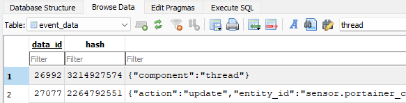

Out of interest, I’ve been poking around in the DB and found this.
Can I delete that line so HA doesn’t think Thread is installed anymore? This is only reference I can find to Thread in the DB.
Highly discourage directly editing any databases — that’s a great way to break something.

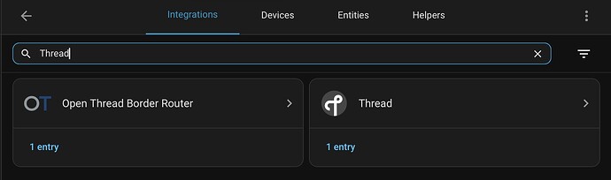

If you go to settings → devices, and search for Thread, ideally you should see the image below. If you do not, click the filter icon (upside down triangle to the right of the search bar) and make sure you haven’t disabled one or both.
The one on the left, “Open Thread Border Router” is only present if you’ve linked HA to your OTBR container, using its REST API. Unfortunately the UI won’t show you any details currently, it only shows a red error if something is wrong. This one should allow you to add new entries (if you have more than one OTBR).
The one on the right, “Thread” can only exist once, and has a settings page that shows networks detected by HA. There is very little on this page you can configure; most of it is read-only. If one of the detected networks is your OTBR, and if you have the OTBR integration as shown above, you will have up to three additional options in the “three-dot menu” next to the router name (reset, change channel, and add to preferred network).
Thank you so much, it is now working! It turns out it was ignored and hidden, I can’t believe I didn’t think to check that. Thank you to everyone for the help, this fixed has helped me regain the wife approval factor that was slipping away as the thermostat wasn’t working properly!
