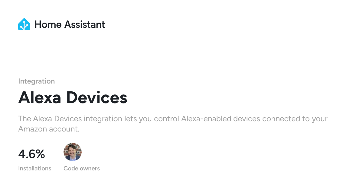

Alexa devices

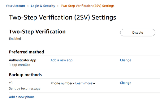

Probably worth following the instructions linked on the integration page to the Amazon documentation on OTP.
Specifically:
https://www.amazon.com/gp/help/customer/display.html?nodeId=G9MX9LXNWXFKMJYU
If you already did that, more details of the issue would be helpful.
When configuring Amazon Two--Step Verification (2SV) Settings, ensure Authenticator App is the primary or preferred method.
