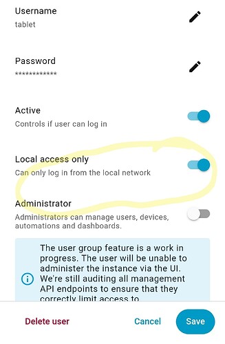

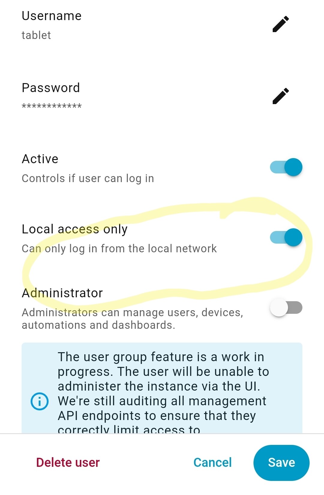

Check your user. There is a local only setting. Make sure that is not marked.
I don’t see a local only setting under my user settings or Nabu Casa settings. Can you tell me where I can find this setting?
-Thanks

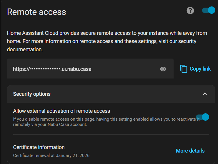

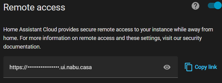

I mispoke. My current password for accessing Home Assistant, does not work with the remote URL used to access HA remotely. I have external access checked as you can see below.
-Thanks
I misspoke. See my response below. My HA credentials do not work with the remote URL. I have remote access checked. I might try changing my password and see if that has any affect.
