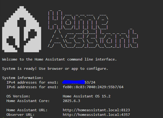

If you plug a monitor into that PC running HA, what do you see should look something like
Your IP will be different

I see this same page that you posted but no ip address on it
