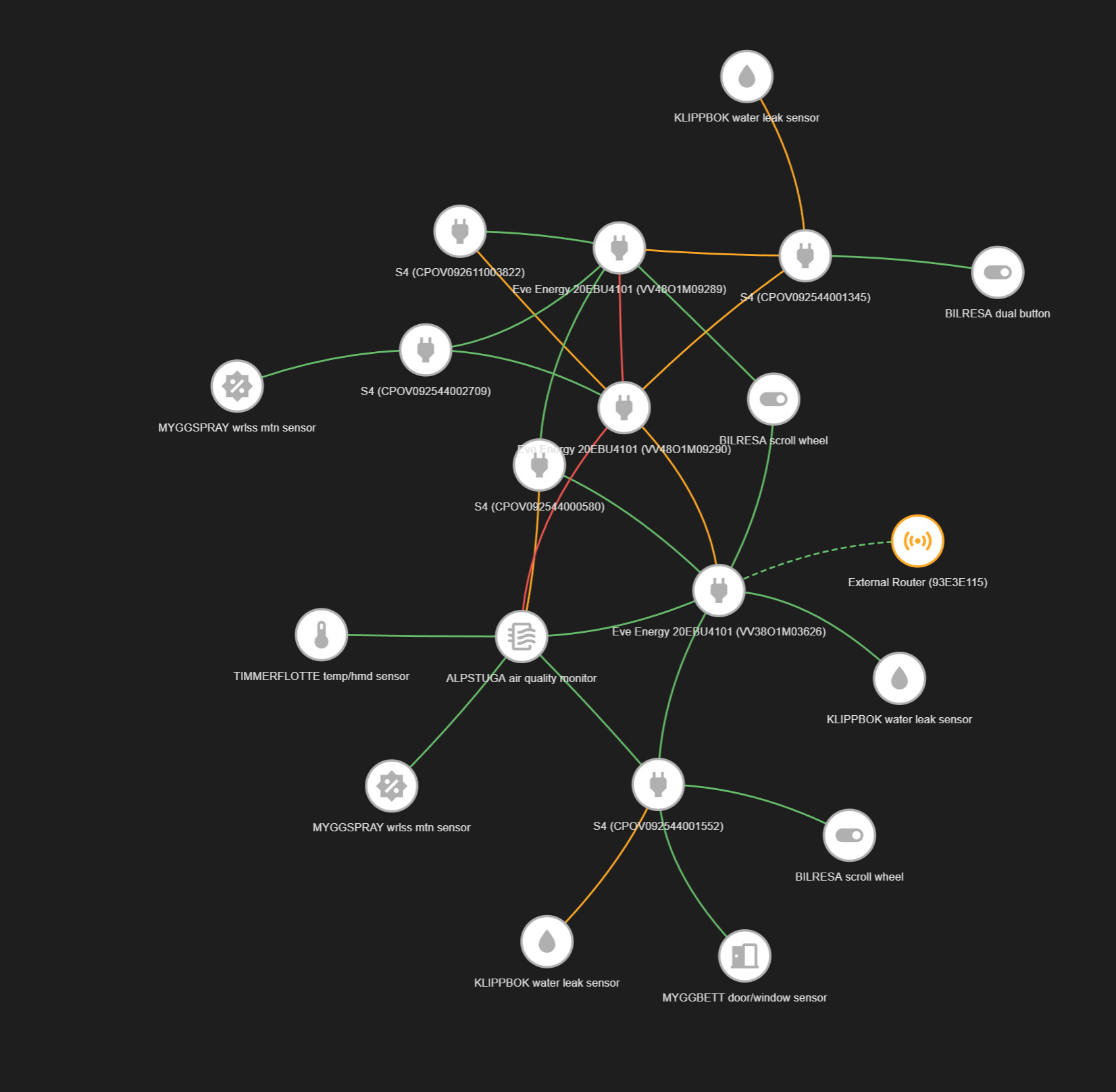

I got to 21 Matter/Thread devices connected, then all of a sudden couldn’t add more. Spent a couple of days with Chargpt and gemini, no joy. Then I moved the HA green and the ZBT-2 to the other end of the house - away from the Unraid NAS. Voila, all is good:)
Only issue now is a rouge external router!
Probably your TBR…
The message associated with it is “This device appears in Thread neighbor tables but is not commissioned to this fabric. It may be a Thread Border Router or a device from another Matter ecosystem.”
So physically which device?
Right… but it should show as a minimum your TBR with the dotted line, and since there are no other dotted lines, really nothing else it can be.
HA OTBR w. ZBT-2
Thank you. That helps a lot!
Running your suggested command solved the issues for me (both DIRIGERA and Appletv4k as border routers running HAOS on a rpi) thanks.
