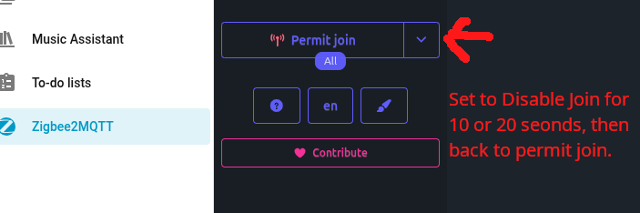

I finally got this to work. I found a post that said disabling join for 20 seconds and re-enabling it fixes the problem. No idea why. I had one out of 5 bulbs that suddenly came back. Soon after I found the post and tried it. The other 4 came back right way.
