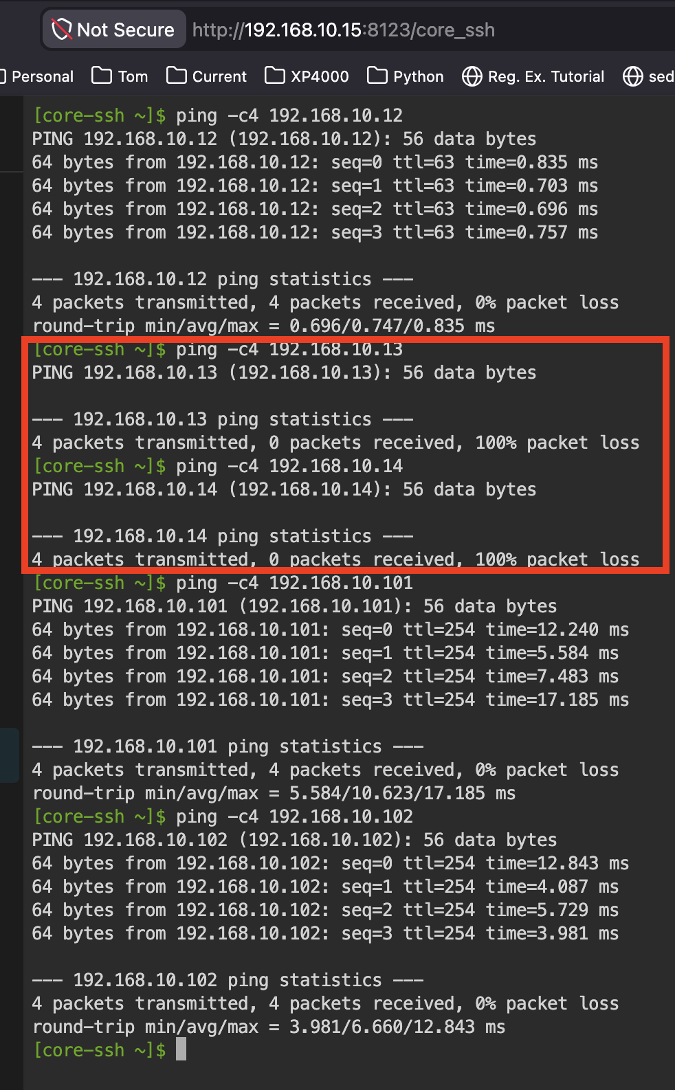

When I open a terminal in Home Assistant, I can ping all devices on VLAN_IOT except the two devices on ports 17 and 18, the Zigbee Coordinator and the Hue Bridge. All addresses are in the same range 192.168.10.xxx. Please see a screenshot of the terminal inside Home Assistant:

I remember that some time ago (measured in years) I had an IOT device that was misbehaving on the port that now has Home Assistant connected to it. I enabled port isolation on that port, and only that port. Since I was solely focused on ports 17 and 18, I didn’t think about checking port 1. I turned port isolation off for port 1, and it works!
So this was a clear example of user error, years in the making.
Thank you for your time spend on my issue.
