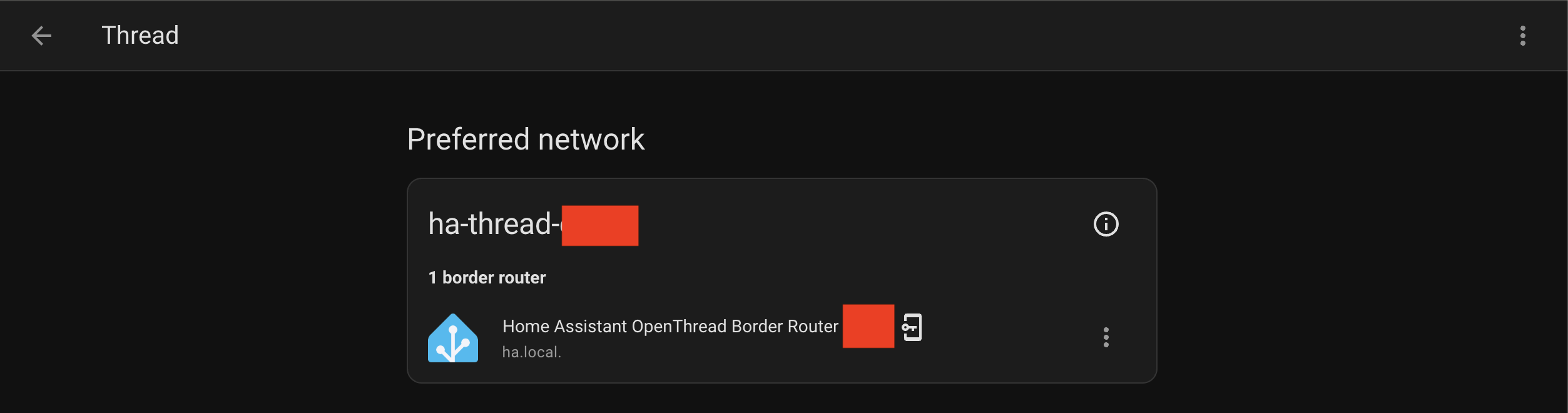

  2. Connect phone to IoT Network (vlan)
  3. Sync the Thread Credentials

  • Thread Boder Router: Home Assistant Connect ZBT-1

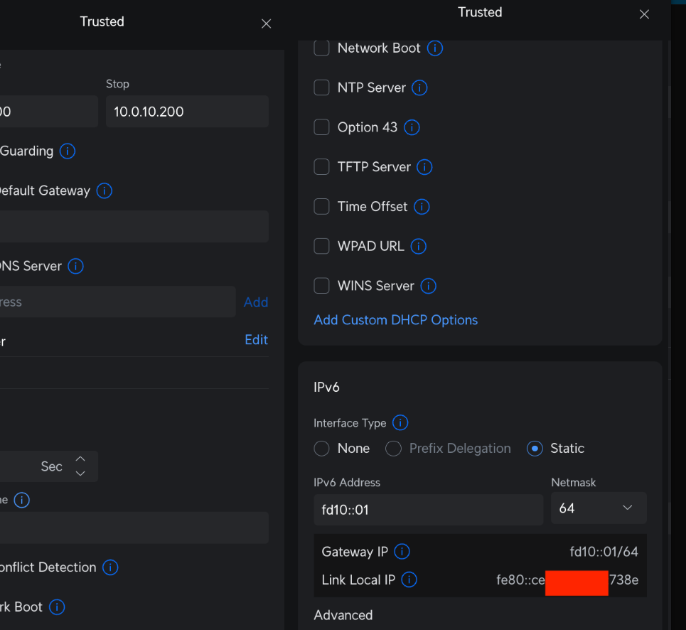

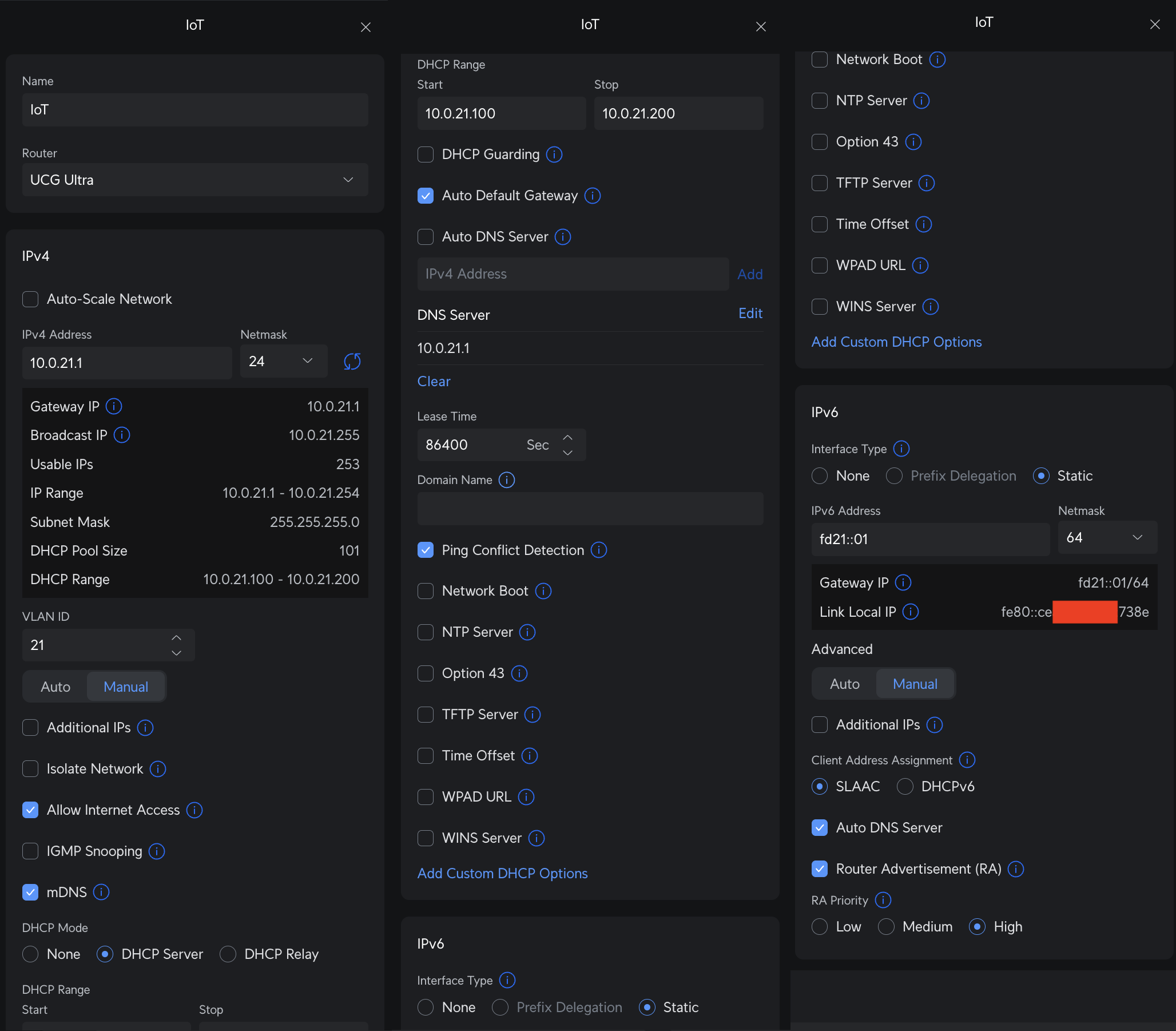

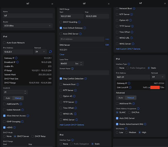

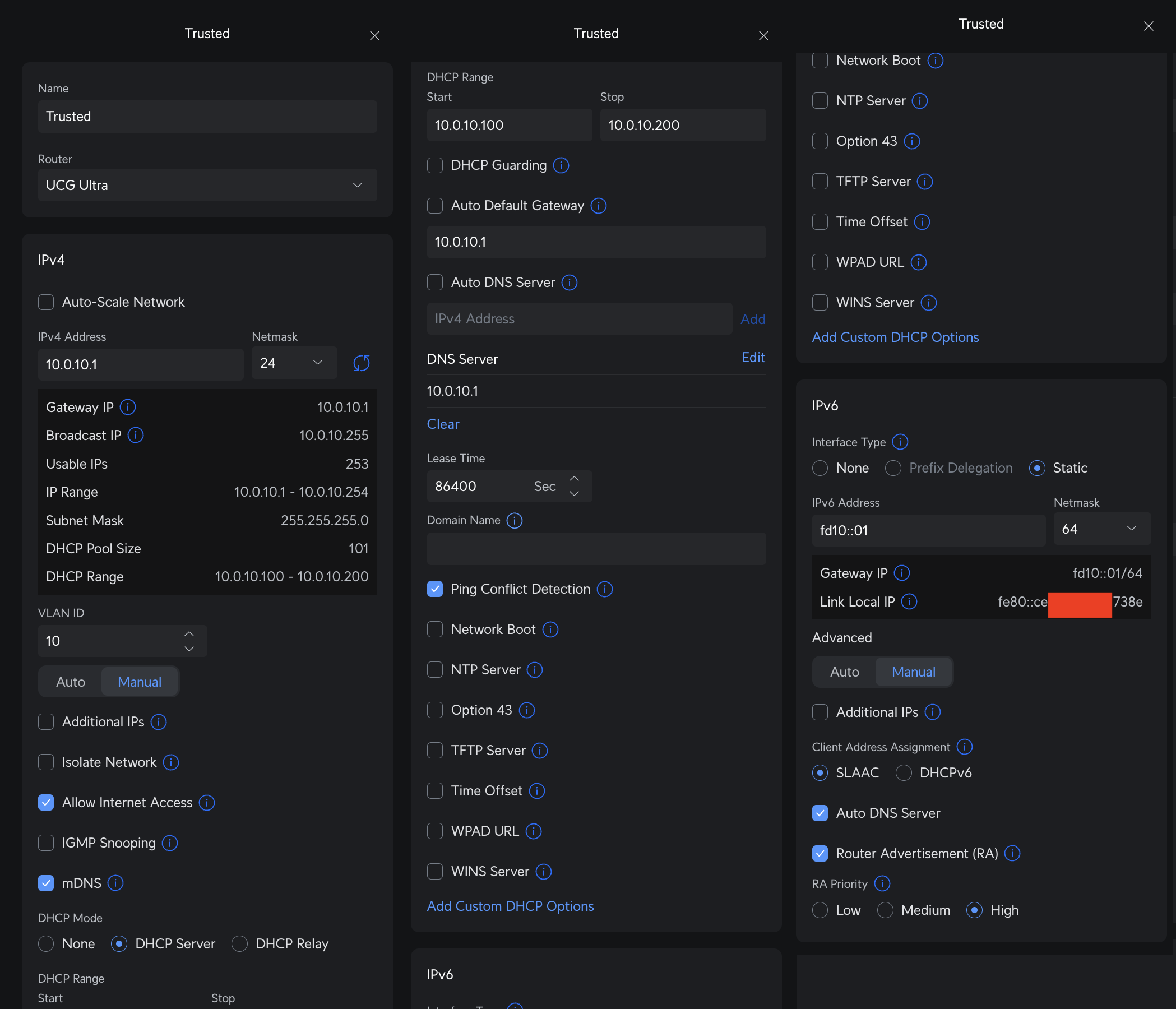

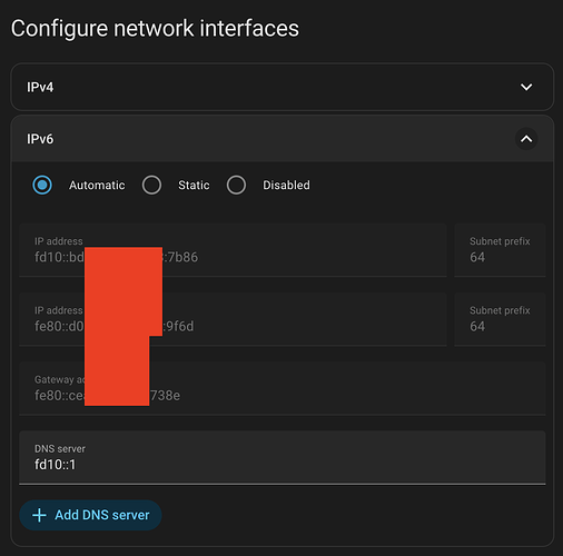

HA Network Config:
Network Configs:
(both have the same Link Local address for some reason)

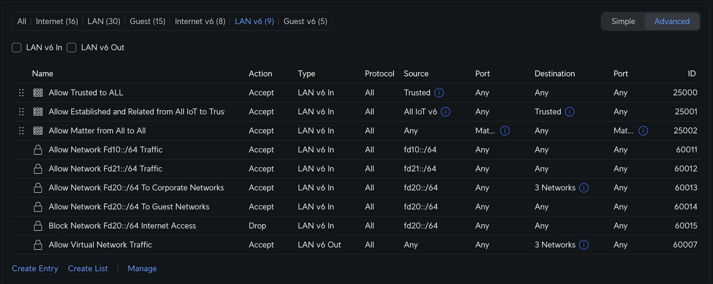

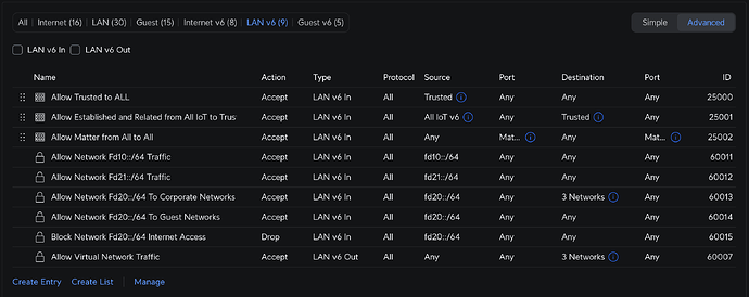

Firewall rules (IPv6):
Where Matter = Port 5540

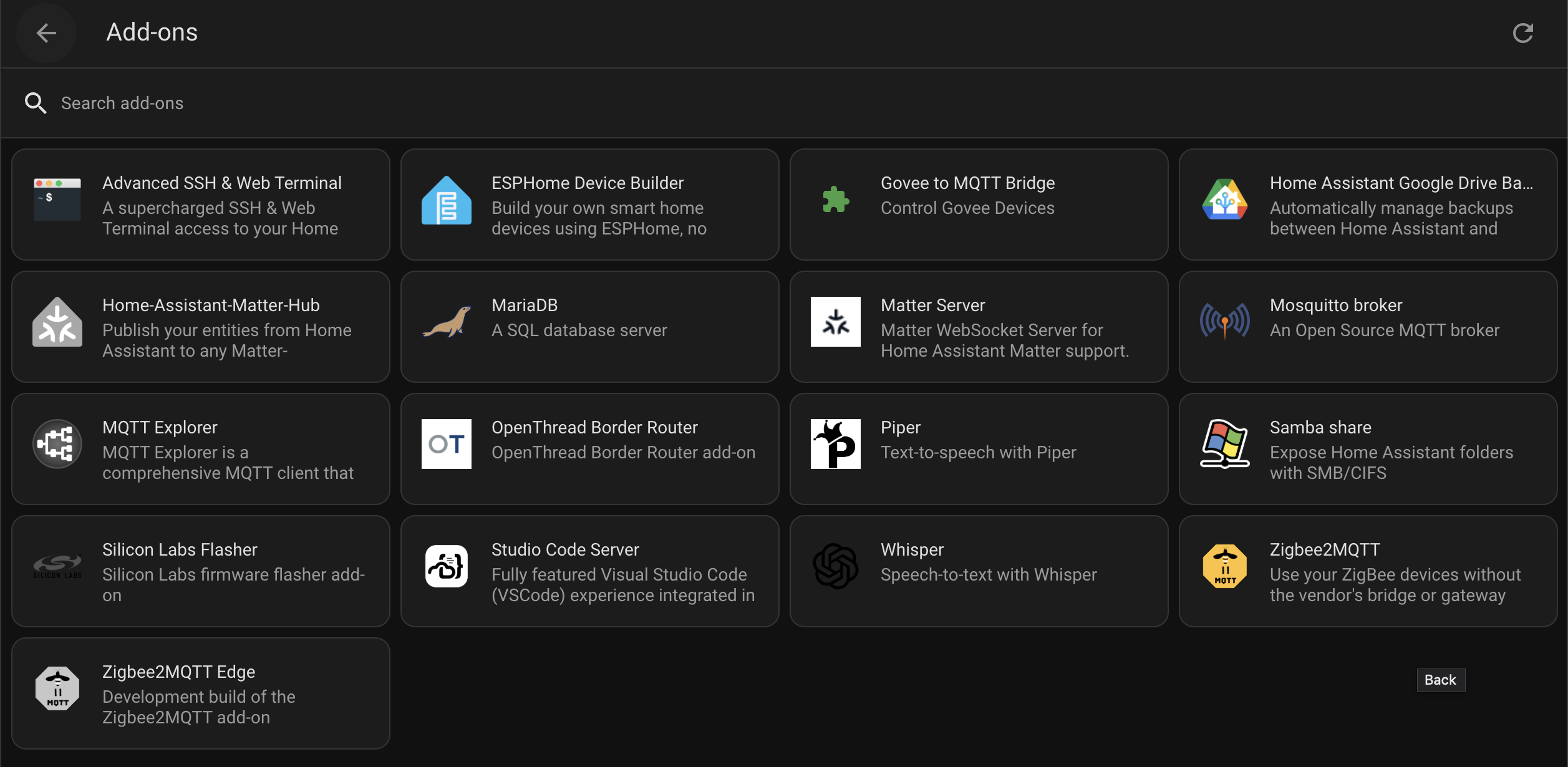

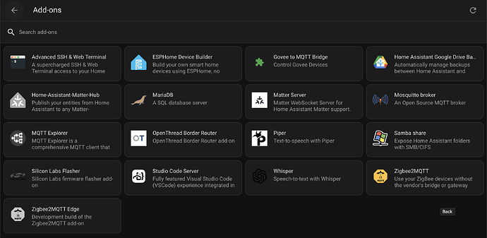

Installed HA Add-Ons:
:grey_exclamation: Notice some are disabled, like Home-Assistant-Matter-Hub.
Thread Hardware:

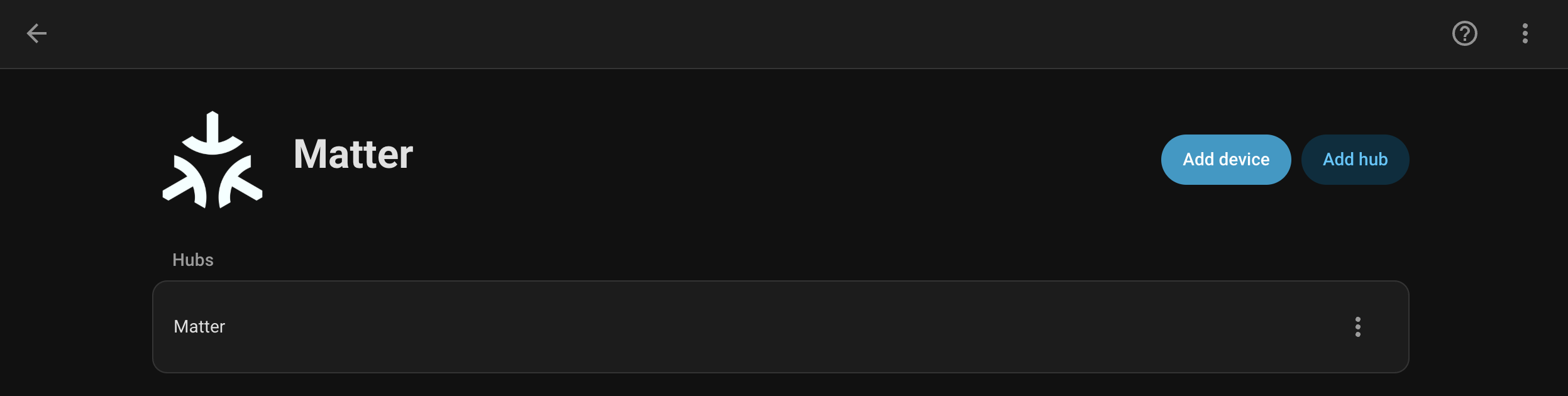

Matter:

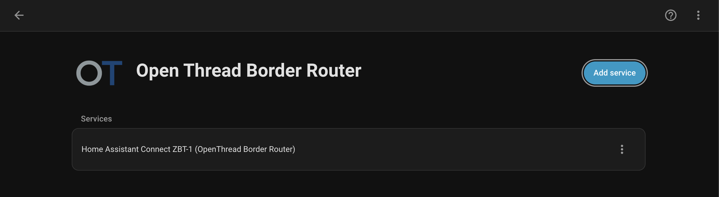

OTBR:
Thread:

Matter device, provisioning device (your phone), HA server and matter server must be on same vlan and WiFi network
Basically don’t try getting this across vlans
WiFi because there’s nothing allowing you to choose, it just joins the current.
That’s really difficult for me.
I don’t trust IoT devices to be in the Trusted VLAN as it provides access to lots of sensitive things I want to keep tight control over.
There must be a way to do it, as I’ve read around. I just don’t know what I’m doing wrong. I suppose it is something Firewall related.

I’m no expert on this but since your ‘Trusted’ VLAN has a gateway of:
I think your IoT network need the same Gateway IPv6 address. ie: fd10::01 instead of fd21:01
It is not configurable. It will use exactly the same address as entered in the IPv6 Address.
Maybe I’m using an invalid value here, though. I’m not that experienced with IPv6.
Initially I thought I’d put fd10::, but that’d be an invalid address for both, right?

I just had a look at mine and yeah, they are different between the trusted and IoT VLANs. I haven’t yet setup any Matter over Wi-Fi devices, only Matter over Thread and my Thread router is on my trusted VLAN. (I have some Matter over Wi-Fi devices ready to setup next week so will see if they are happy on my IoT VLAN or not soon)
