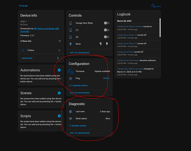

Entity category is I think Diagnostic or Configuration, for entities of a device that are not considered it’s primary entities. They appear in separate lists in the device page.
That’s a good point, that probably explains why they are excluded for OP.
