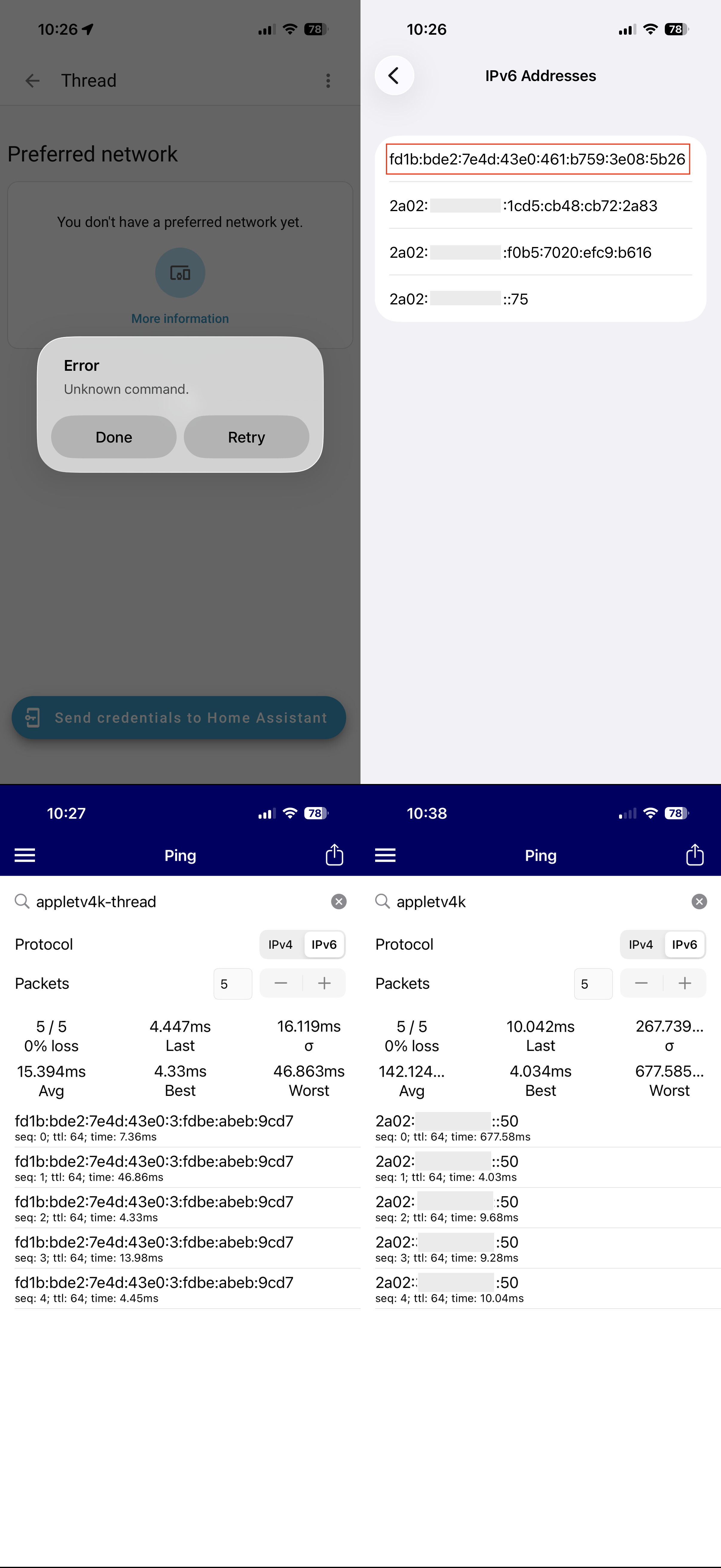

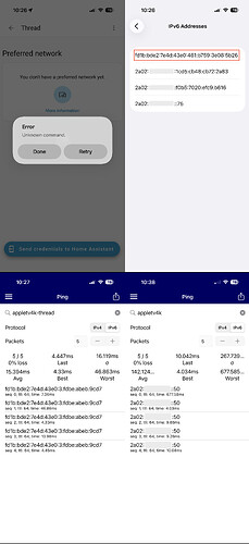

UPDATE: When the companion app gives the ‘Unknown command’ error I see this in the HA log:
2026-04-01 13:46:31.752 INFO (MainThread) [homeassistant.components.websocket_api.http.connection] [281471731087648] Received unknown command: thread/add_dataset_tlv
So it seems the companion pp is sending a command that HA does not understand. I;m running HA 2026.3.3.
I have a fully functional Matter/Thread network with several devices. These devices are all exposed to Home Assistant via Matter (HA Matter Server) and are working fine, and very reliably, with both Homekit and Home Assistant. I have 5 Thread border routers in my Thread network; Apple TV 4K (ethernet connected), Homepod2 (WiFi) and 3x HomePod mini (WiFi).
In the companion app (most recent version running on iOS 26.4), ifI go to one of the matter devices and tap on 'View Thread Network. It tells me that I don’t have a preferred network yet and offers me the option to 'Send credentials to Home Assistant then I get the iOS pronto to allow the app to find devices on my local network (which I allow of course) and then moments later the app throws an error ‘Unknown command’ with options of Done or Retry, retry also fails (every time).
My iPhone can ping all of my TBRs using both their home network and Thread network IPv6 addresses.
Any idea what the issue is here? How can I diagnose this and resolve it?

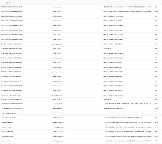

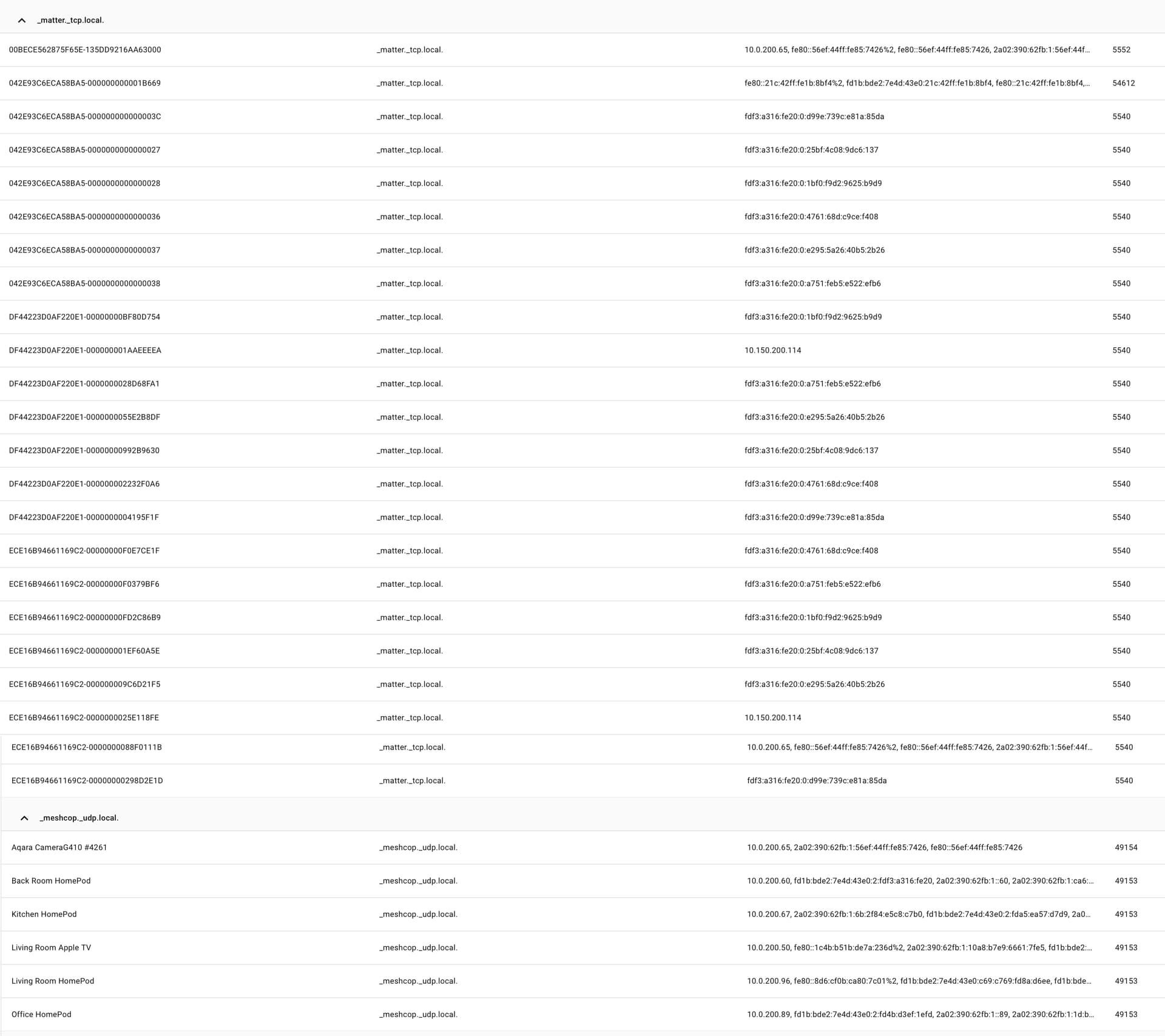

As a check, goto HA’s UI->Settings->System->Network and scroll down to the bottom and click on “zeroconf browser”. Look to see if there are any _meshcop._udp.local or even _matter._tcp.local. If not then HA is not seeing them but it should which likely means there is something in the network blocking HA from getting them.
They are all shown there (as expected):
That’s good!!
But no idea (and very strange) why the Thread Integration is not picking up all the Apple TBRs.
