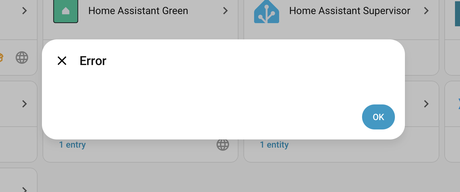

I’ve spent a few hours today trying to get the Tesla Fleet integration installed and keep hitting a brick wall. I’m following the instructions on the integration’s page. After I authenticate with Tesla and then try to redirect to Home Assistant I just get an unhelpful ‘Error’ dialog box like so;
I don’t know where to look for more details about what is going wrong here as log files no longer seem to be part of Home Assistant. I am behind CGNAT which may be an issue here? I don’t think it should be a problem until a few more steps down the instructions (I am planning on getting around it by using Tailscale Funnel).

Logs are still available but through the UI, go to settings>System>Logs

I had seen those logs in the UI but didn’t realise I had to click through to get details. Actually quite a nice setup. Anyway, I found the following in there which will point me in the right direction. Obviously I haven’t set up something quite right. I will hack away at this. Does anyone have any ideas?
ValueError: Partner login failed: {‘error’: ‘invalid_scope’, ‘error_description’: ‘The client is not allowed to access the requested resource.’, ‘referenceID’: ‘715b78fe-c74c-4c8c-a433-368bf842c7ce-1765628800358. For more information, visit: https://developer.tesla.com/docs/fleet-api#help-and-support’}

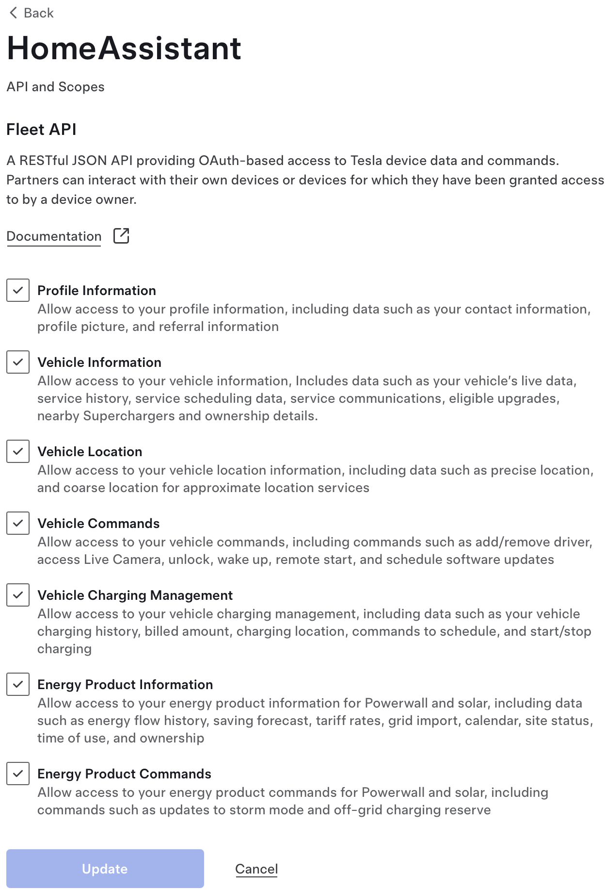

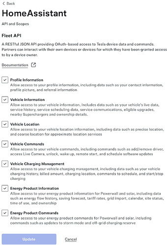

I used all of the scopes to register the application in the developer portal as per attached screenshot. Sorry I can’t be more helpful.
