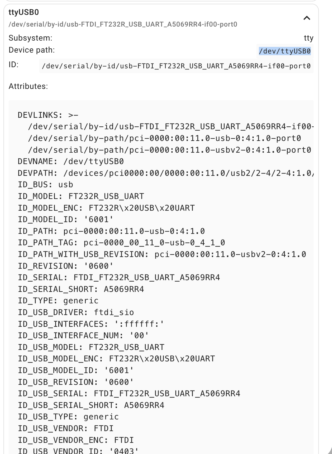

I try to setup a modbus connection between HA and a Growatt inverter. I bought a Modbus USB module. Iam running the 2025.5 HA verson on Proxmox. I do see the Modbus module in HA (see printscreen) but get an error. What do I wrong?
My coral USB and Zigbee USB sticks are working fine. So the passtrough Proxmox seems to work fine + I do see the Modbus USB module in HA
