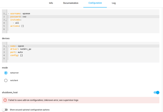

please help me with an issue:
Network UPS Tools (NUT) addon doesn’t want to start - it demands a password (please find the log below).
But it is impossible to set the password - error appears: Unknown error, see supervisor logs.
The HA log contains:
Failed to to call /addons/a0d7b954_nut/options/validate.
How to fix this problem and start NUT addon?

Share the addon configuration you are attempting.
Blockquote
Please find addon configuration in my updated initial message.

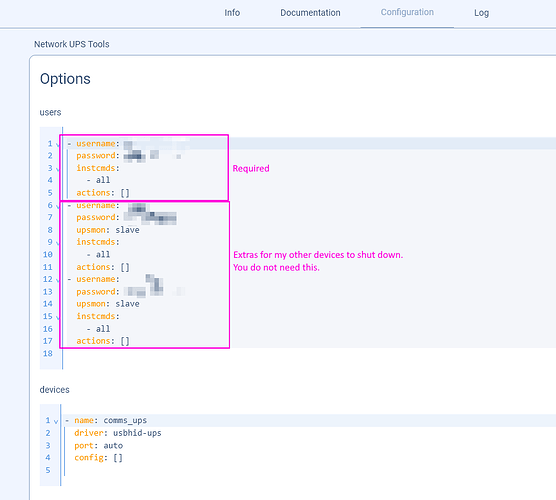

You don’t have a password.
When I set password and try to save configuration error appears:
system log
Logger: homeassistant.components.hassio
Source: components/hassio/websocket_api.py:145
integration: Home Assistant Supervisor (documentation, issues)
First occurred: August 9, 2025 at 11:07:31 PM (6 occurrences)
Last logged: 6:30:43 AM
Failed to to call /addons/a0d7b954_nut/options/validate -
Failed to to call /addons/a0d7b954_nut/stats - Container addon_a0d7b954_nut is not running
so looks like closed circle - to start addon needs password, to set password addon needs to be started )))
NB: configuration can be saved without password only
