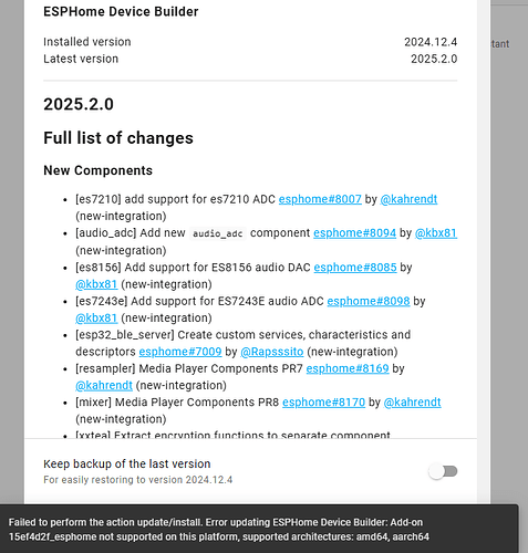

Whan I try to upgrade from 2024.12.4 to 2025.2.0 I get the following error
“Failed to perform the action update/install. Error updating ESPHome device builder, Add-on 15ef4d21_esphome npt supported on this platformm supported architectures” amd64, aarch64"
Host is a Rpi 4 with 4GB RAM.
Any ideas?

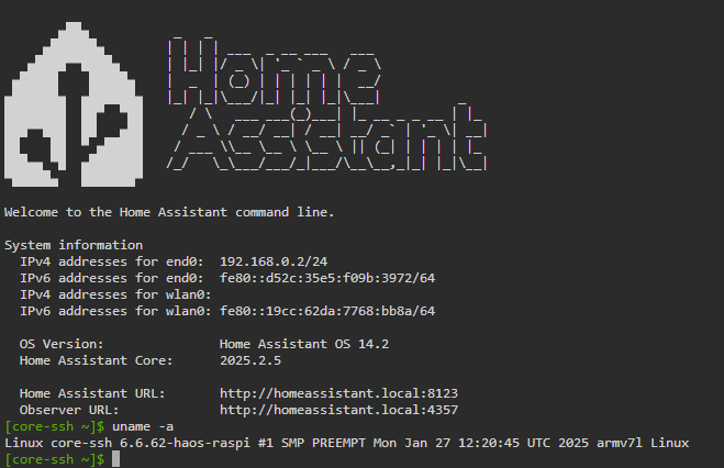

32 or 64 but?
How do I tell?
Try
uname -a
In the terminal.
armv7l :do_not_litter:
Was 32 bit OS for the pi 4 ever a thing :thinking:
My RPI4B 4GB reports the following:
Happily running ESPHOME 2025.2.0 (there is an update available for 2025.2.2). Doesn’t help you, but shows it’s still working on an RPi 4.
with aarch64 as expected :muscle:
