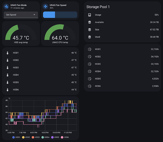

Since there is still no official support for the UniFi UNAS Pro via the UniFi Network integration, I’ve built a custom integration for it to have monitoring and fan control in Home Assistant.
Available data includes drive temperatures, SMART data, CPU temps, memory usage, storage pool metrics, and fan speeds. All sensors appear as proper HA entities with automatic MQTT discovery.
The fan control system has three modes: let the UNAS manage fans natively (whichever mode is selected in the Drive UI), use a custom linear temperature curve with configurable parameters, or lock to a fixed speed.
Setup is straightforward: the integration automatically deploys monitoring and fan control scripts to your UNAS via SSH, configures systemd services, and handles MQTT auto-discovery. The scripts are designed to survive firmware updates and auto-recover if needed. Everything that was installed by the integration onto the UNAS will also be removed from it when uninstalling the integration.

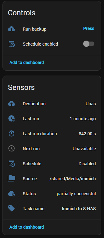

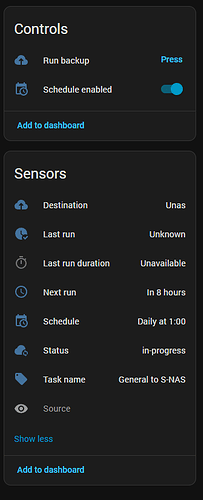

This is a screenshot of a backup in progress (“Source” hidden for privacy but shows all paths correctly)
During a backup task, “Last run” becomes “Unknown” and “Last run duration” becomes “Unavailable”
Once complete, these fields populate so this is what I’ve used to confirm the backup is finished (regardless of completion status)
Glad the integration is working for you so far, and with UNAS to UNAS backups too!
I’d actually advise against using those unknown/unavailable statuses for automations. That’s an oversight on my part I plan on fixing in a patch release in a few minutes so it would always use values from the latest started backup task.
It works for now in v0.8.0, but it’s clunky since unknown/unavailable can mean almost anything, and with unlucky timing could even trigger one of your automation steps if the entities go unavailable for some unrelated reason and come back up within your specified time window.
Best to use the status entity directly, trigger when it changes from in-progress to a terminal status like succeeded, partially-successful, or failed. The full list of statuses (named exactly as they appear on the UNAS):
