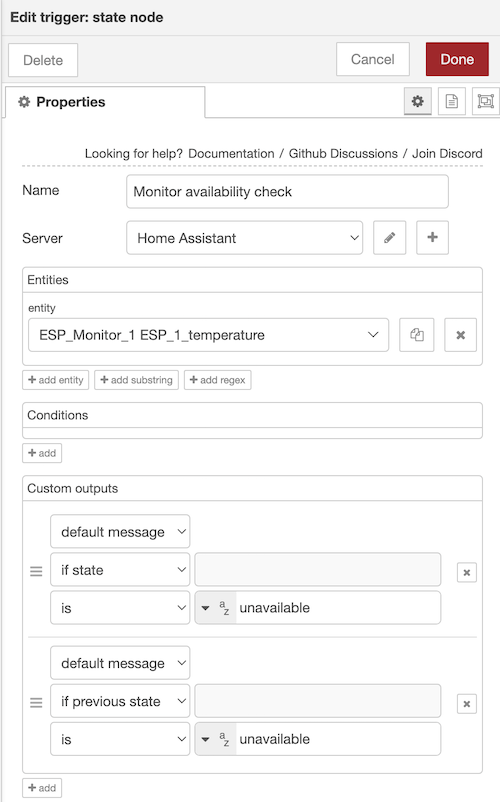

I’m trying to figure out how to monitor a state-change from Home Assistant entities - I can get it to tell me when an entity becomes “unavailable” but struggling to figure an easy way to notify when it becomes available again??
Is there a simple way?
I tried this but nothing happens when the entity goes unavailable so I must have gone a bit wrong ??

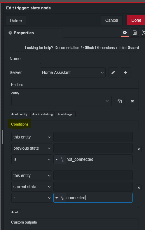

The entity that you are watching, is that an entity that returns the temperature? If so add a connection sensor instead. Then in the trigger node use the conditions section, not the custom output section.
Brilliant, thanks, I’ll add that sensor and try again.

And just to clear something up for you.
States will only be updated in HA if they are different from the previous one, so a state of unavailable together with a previous state of unavailable is not possible.
You could use previous state is unavailable and current state is not unavailable.instead.
Thanks all, it’s working now.
I added the binary sensor and changed the state node. The conditions are actually “on” and “off” but its going now.
