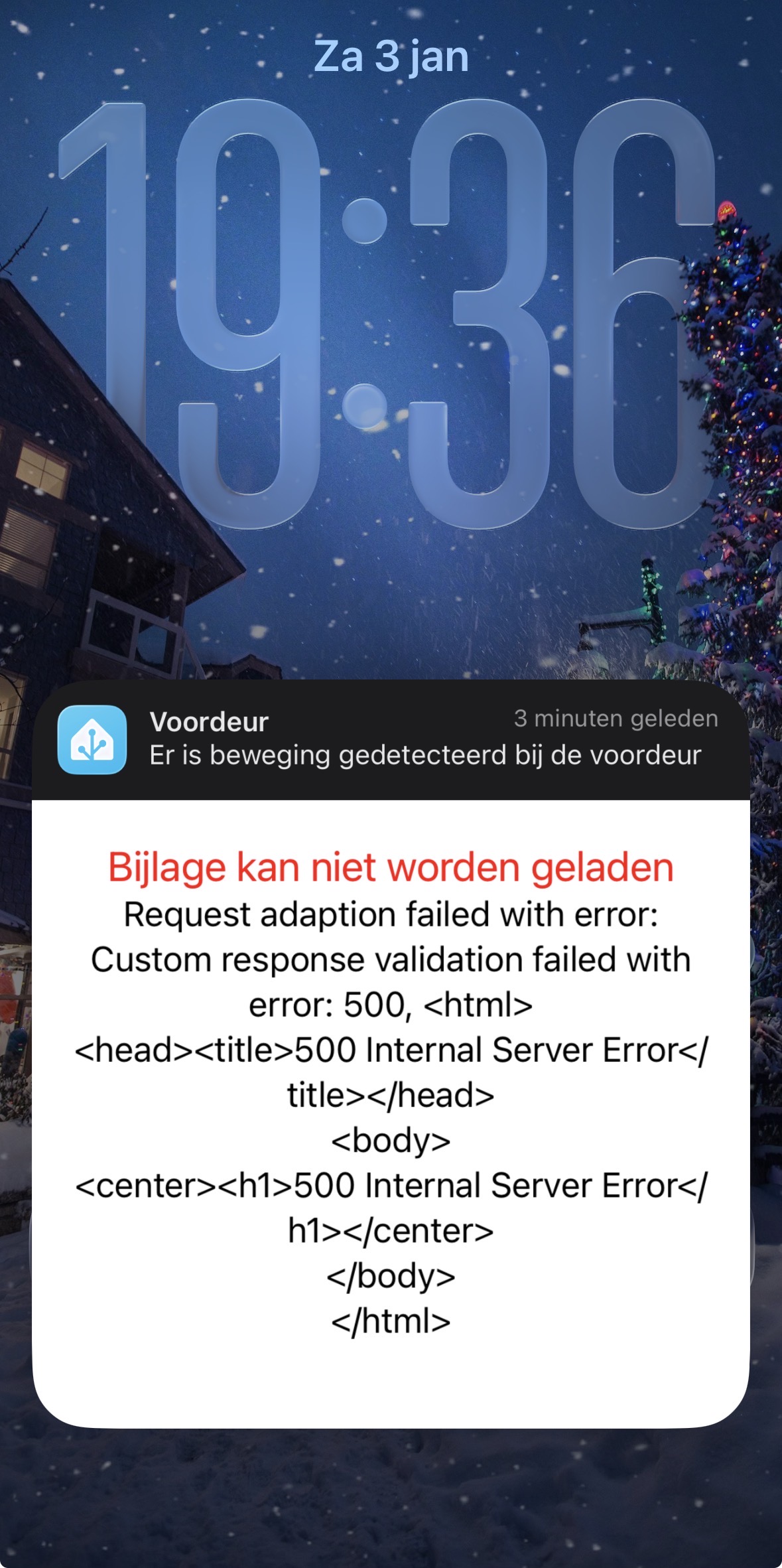

But the other strange thing is that i’m still getting push messages.
Gor example; i have a reolink doorbell. When someone is in front i get a push message with a screenshot. I still get these :confused:
Then I suggest you look through the logs when you have physical access to the machine.
The ISP may have changed your external address, things may need to catch up. What are you using for DDNS?
Last time this kind of thing happened to me it wouldn’t come back until I rebooted the router.
My quess is not. I have a domainname forwarding to my ISP IP. Ik can still see the homescreen true my domain
Now even the image fails :stuck_out_tongue:
This screen is not browser cached, is it?
No this is a push from the app and the image is saved in my HA instance until overwritten
