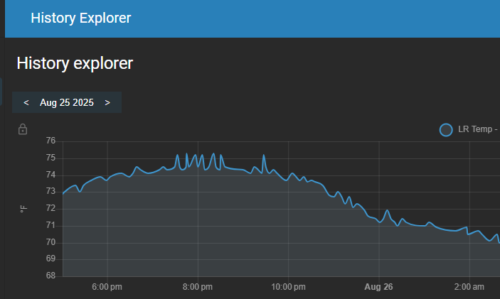

Is it possible to set somehow minimal y-axis range (not ymin offset!)? I mean I have sensor that reaches any values between 0 and 500, but meaningful data is coming for relatively short time (few times per day for few minutes) when some devices are used. Outside this window sensor state oscillates around very small values (call it background noise) that are in range of 0~0.001 and are negligible to what I’d like to be drawn. Yet automatic scaling stretches chart trying to display this meaningless data, which is somehow misleading, as in reality nothing important to observe is happening. It would be great to be able to set fixed, minimum scale for y-axis (lets say to 1) to make such noisy data variation unnoticeable unless meaningful and then normally scale the chart up to maximum data received. Any advice?

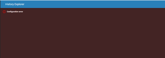

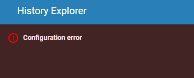

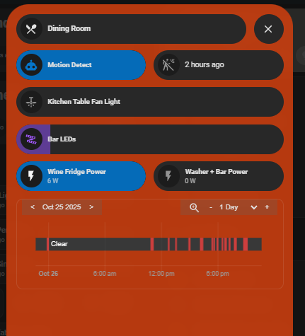

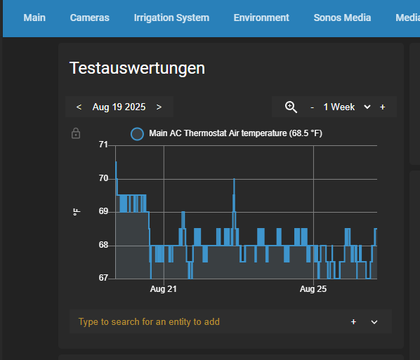

I’ve run into another problem by using the PR file for the more-info card…
I opened up a (rarely used) history explorer card panel and I got a big red “! configuration error” notification in that view.
So I made sure that my history explorer card was up to date (the one from HACS was). so I switched my lovelace resources back to using that one.
Then my history explorer card panel view worked again but then the more-info stopped working again.
So it seems that we can only have one of the two functionalities working until this PR gets merged?
there’s nothing that tells me what the config error is using the new PR file.
just this:

would you mind giving me your card config just to be sure I didn’t screw that part up somehow? I don’t think I did since it’s pretty basic but you never know. :smile:

I guess there isn’t anything really special about using the card in a panel or in a normal view. Would you mind posting the yaml for your card you configured via the UI?
e.g.
type: custom:history-explorer-card
stateColorSeed: 137
cardName: history-explorer-card-47111
showCurrentValues: true
refresh:
  automatic: true
  interval: 30
timeTickDensity: height
stateTextMode: auto
tooltip:
  showColorsLine: false
  showColorsTimeline: false
  showDuration: true
  showLabel: false
  stateTextMode: raw
defaultTimeRange: 7d
header: Testauswertungen
decimation: false
lineMode: stepped
uimode: dark
showUnavailable: false
recordedEntitiesOnly: false
axisAddMarginMax: true
axisAddMarginMin: false
rounding: 2
statistics:
  enabled: true
  mode: max
uiLayout:
  toolbar: top
  selector: bottom
uiColors:
  gridlines: grey
  labels: "#ffffff"
  buttons: "#2e2e2e"
  selector: "#2e2e2e"
  closeButton: "#2e2e2e"
stateColors:
  gestoppt: "#414141"
  "on": "#6da620"
  "off": "#414141"
  open: "#ad3631"
  closed: "#6da620"
  tilted: "#ff9800"
  locked: "#ad3631"
  unlocked: "#ad3631"
  battery.on: "#ad3631"
  battery.off: "#6da620"
  door.on: "#ad3631"
  door.off: "#6da620"
  shutter.open: "#649ace"
  shutter.closed: "#6da620"
entityOptions:
  sensor.sensor:
    type: line
    lineMode: stepped
card_mod:
  style: |
    button2 {
      background-color: #2e2e2e;
      border: none;
      color: #ffffff
    input {
      border: none !important;
    input::placeholder {
      color: var(--secondary-text-color);
    br {
      display2: none;
graphs:
  - type: line
    entities:
      - entity: sensor.aussenthermometer_actual_temperature
Thank you.
I’ll give it a try when I get some time.

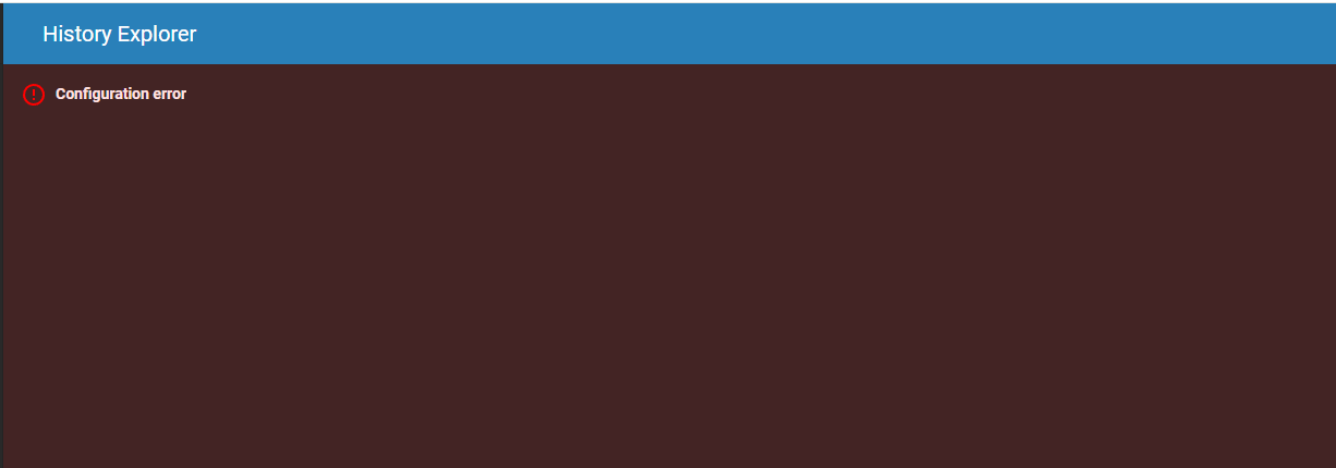

Nope.
I tried your exact card config with the only difference being that I replaced your entity with one of my own and I get the same result.

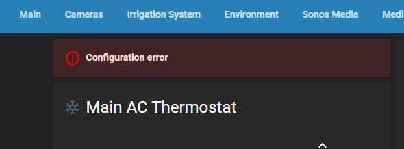

I even tried it as a regular card in a regular view instead of a panel view and get the same error:
if I switch back to the HACS version then the panel/card works but the more-info panel doesn’t.
I’m not sure what would be the difference between yours and mine tho.
