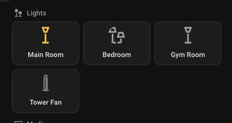

Undo the circle of a tile icon?

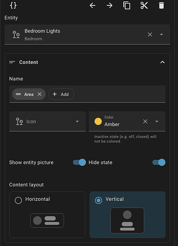

In short, I’m using tiles with card-mod to increase the icon size to 40px. When doing that, my larger icons are getting cut off by the circular representation of the tile icons. How do I disable the circle aspects of this?
