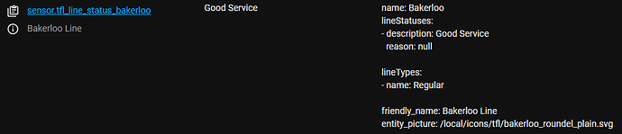

The unexpected behaviour is that the original sensors create entities in HA with the ‘correct’ name/unique_id i.e.
sensor.tfl_line_status_[line_name]_line
Whereas the new sensors in identical format don’t.
sensor.[line_name]_line
What is going on here?
Thanks.
PS Note that as the entity_id is ‘wrong’ my customised entity_picture isn’t applied.
The sensor name of the new entity is correct. It’s derived from the name.

Those configs I posted are the configs I’m using with results shown in the screen shots.
Your gripe is that the new sensor entity_id is not sensor.tfl_line_status_mildmay, right?
That is expected.
The fact that the “old” sensor is named sensor.tfl_line_status_metropolitan is not, actually. It should be named sensor.metropolitan_line, based on its name.
So my guess is that you renamed the first one through the UI
