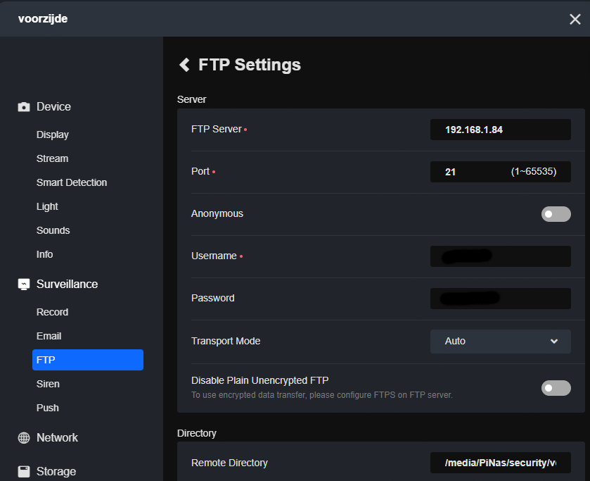

I have a few Reolink security camera's that when detecting movement they stream some footage. I do not want that to end up on the HA HD but on the network storage. For that I created a network storage in HA. This storage also shows up in HA media and is accessible from there. The storage is also accessible from a windows PC via a file explorer outside of HA because it is just a NAS.

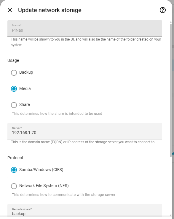

I have added this external storage to HA via Setting - system - storage - network storage

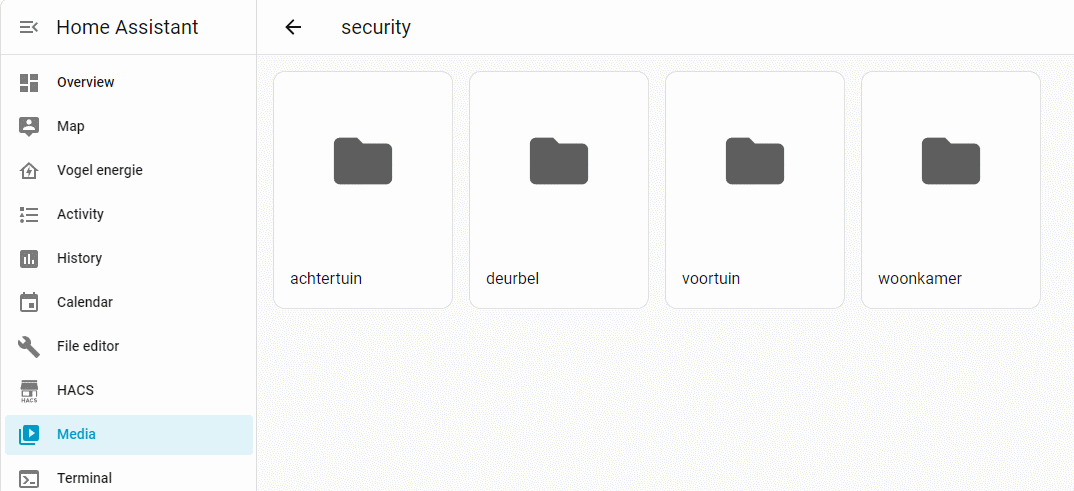

In HA going to media and following the links then the folders on de NAS appear.

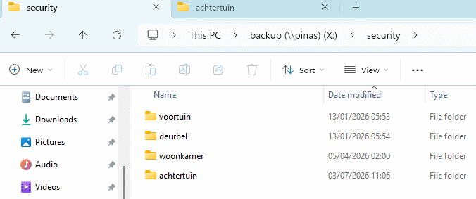

In a file explorer the folders also appear
The Reolink camera's uploads their stream via FTP to the HA server and stores it in the network storage link.

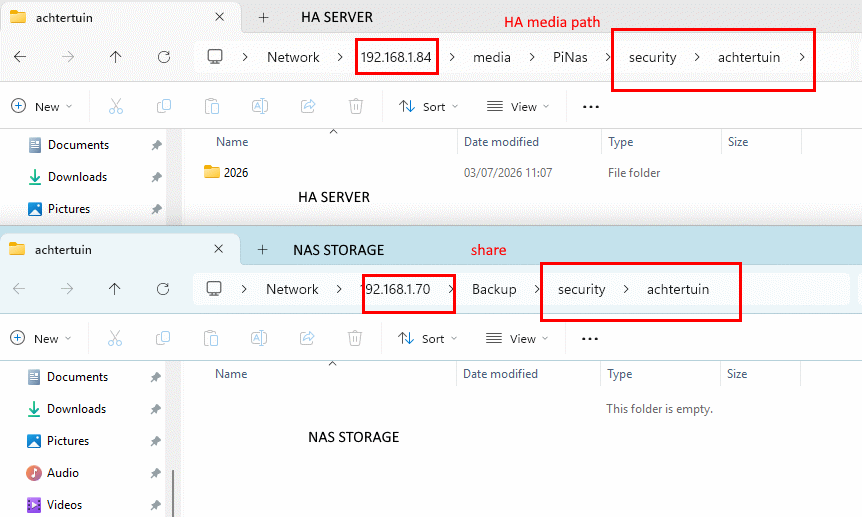

If I go on the HA server via media and go to where the files on the NAS are stored I find the files there.as expected.
Also when I take a file browser on a different machine.and go to de HA server and look at the media folder and follow that onto the location on the NAS the files are there too.
BUT, if i go directly to the NAS then there are NO files there.!?!
So the files are stored on my HA HD despite it following the path to the network storage.
