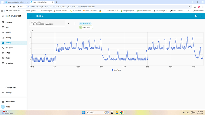

I’m experiencing something I cannot explain or don’t know how to debug.
I have a grow room where I have an automation controlling temperature.
I have noticed spikes in the temperature readings
In an attempt to resolve this I have replaced the sensors along with the Tasmota device they are attached to. That didn’t help.
I replaced the HA server entirely. That didn’t help.
So now I’m perplexed because the system operates as expected except for the spikes that don’t seem to be entirely random.
What else can I test/check?

Have a look at the Tasmota console at the time of the spikes, maybe you’ll find something useful there.
My best guess based on the pattern is that you have some sort of interference going on. Looks like something which triggers every 1.5h during the day & slightly less frequently at night.
A 4-6 degree temp difference is expected in a room with sun exposure or airflow from a furnace.
I’d suggest a secondary temp device to verify if the spikes are legit. It will help eliminate those possible factors.

The periodicity makes me think of a small refrigerator or maybe a dehumidifier…
To me they look like real temp changes, not some single interference spikes.

I can’t really get closer to the issue with this info. Like I wrote before, it looks like temperature raise to me, not interference. Some problem with the relay setup? Temp sensor too close to heat source (even Esp makes heat)?
Keep on eye on your logs. If you can zoom in to those spikes, it might tell something more.
