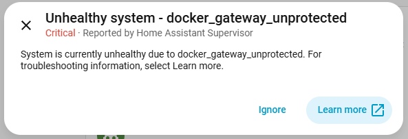

Hi, had very few issues with HA upto now, getting the above message as a critical error. When you click learn more the page does not exists.
Any help appreciated as I am not great with Docker other than the basics.

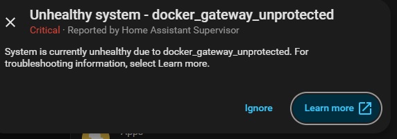

Hi, I’ve got the same critical error (Unhealthy system - docker_gateway_unprotected) and unhealthy state since ~ March 19th. Nothing was changed in hardware (orange pi 3 lts) and configs. Before that - rock stable for months, even with DietPi updates and Debian 13.
