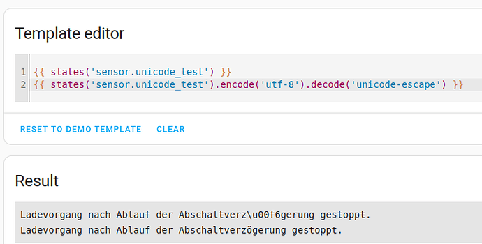

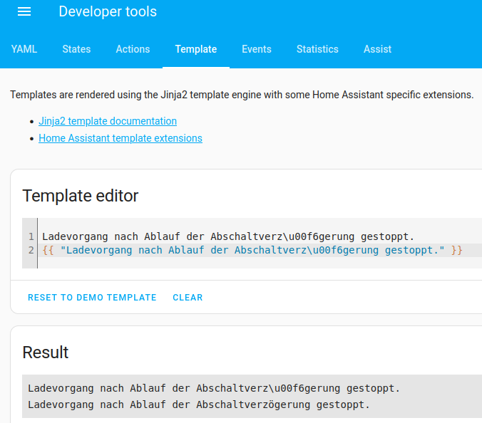

Looks like the template engine converts it:
Does it mean I have to use a template too? Okay, when I add an additional template it works. Is it possible to avoid an additional template and add this to the sensor config?

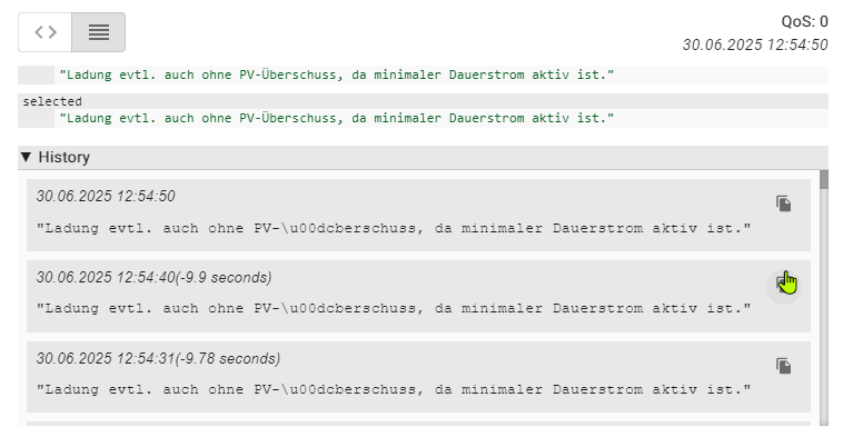

Can you see the MQTT topic in something like MQTT Explorer?
MQTT Explorer shows both:
The config is completely as you wrote above.

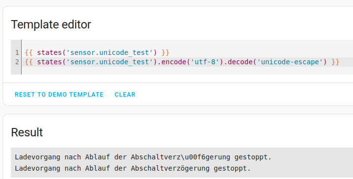

Try:
value_template: "{{ value.encode('utf-8').decode('unicode-escape') }}"
Cool, now it works:
Help me please, what is going on in this line?
It’s taking the (ASCII / unencoded) string with the escaped special characters, converting it (encode) into a UTF-8 bytes sequence, then converting it (decode) into a Unicode string with real characters that are outside the ASCII range.
