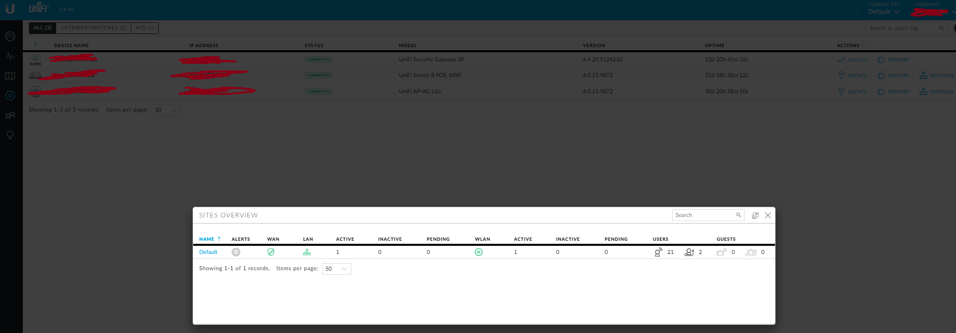

I was able to get it going.
Deleted integration
Changed unifi site name
Readded integration
Restarted home assistant
