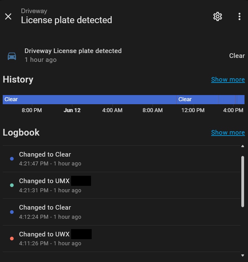

Here is the log for the entity.

My problem is, my automation never fires. I’ve tried an empty From: field, along with “clear” and “Clear.” I’m pretty new to HA, maybe I’m messing something simple up? Here is the YAML from my WHEN condition for this automation.
trigger: state
entity_id:
  - sensor.driveway_license_plate_detected
to: UMX
from: Clear
Does it actually “from: clear”
Have you checked trace to see what is preventing trigger?
Is the to: correct ?
It won’t trigger on part of a string, it looks like you blanked out something ?
Try checking for the full state as shown in dev tools>states
You could check for part of a string and 2 different strings if you use a template trigger
EDIT: just checked my unifi licence plate sensors and they only have states of clear and detected, I have had to use a webhook to get the plate info over to HA. Do yours already have the licence plate info in them ?
I’d trigger on any change to the plate, then examine its contents in the condition block:
triggers:
  - trigger: state
    entity_id: sensor.driveway_license_plate_detected
conditions:
  - condition: template
    value_template: >
      {{ trigger.to_state.state[:3] in ('UMX','UWX') }}
actions:
That will at least trigger and generate a trace that you can use to see what the states are.
