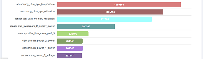

While cleanin database noticed UCG Ultra writes Temperature, CPU and RAM states every 1 second. I also have Flex switches and AC ap’s it is not happening there, only with UCG Ultra.

I tried adding to recorder
commit_interval: 10
but no effect, still every second, how it looks in database for 30 days:
3 entities taking 20% of database

I had to exclude those entities from the recorder because they took up ~ 20 % of my db … annoying that the resolution of the data is so high
