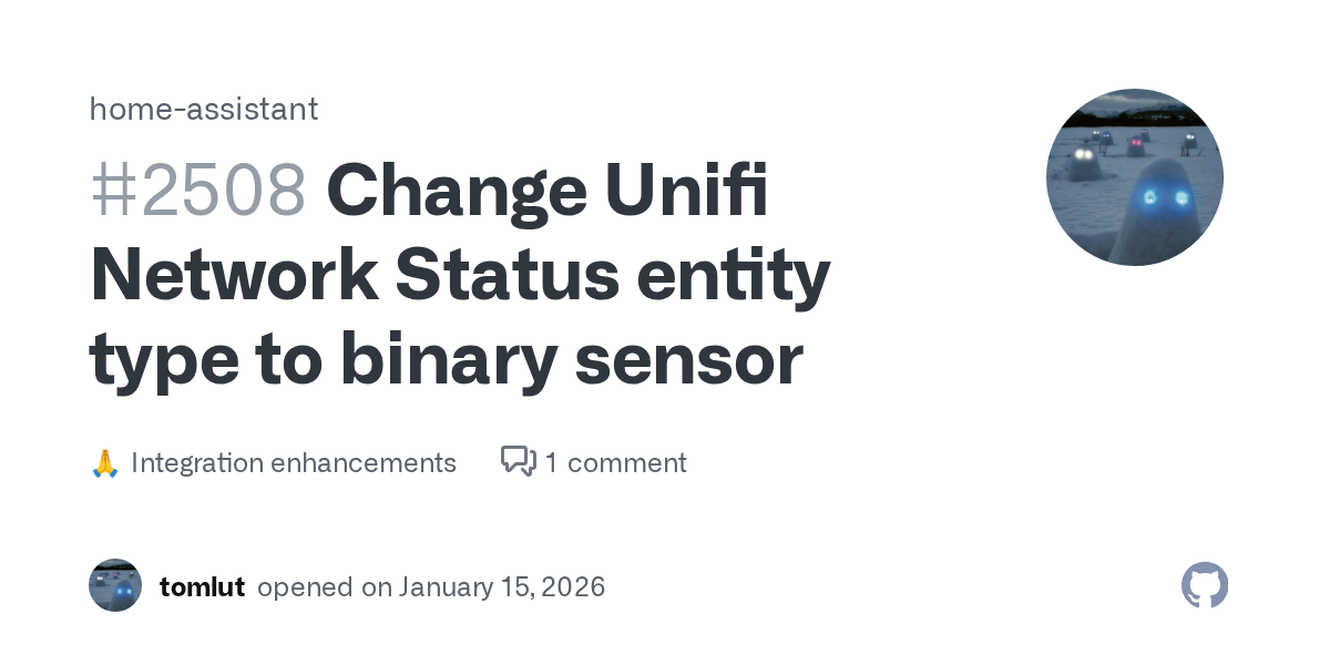

Opened a feature request:

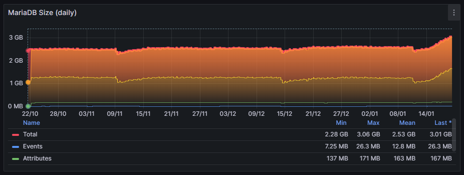

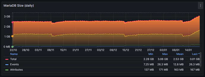

Do the sensors really need to update every two seconds?
My Recorder DB is now growing fast and that is after disabling almost all sensors. Pretty much only 2x WAN bandwidth sensors, a few network device status & update rensors are enabled.
My intentions are to move over to a polling solution rather than using websocket because of the load the amount of data transferred has on many systems. This would also result in the amount of data points will be lower. I have no time plan for it though, its been in my head for the last year - year and a half.
