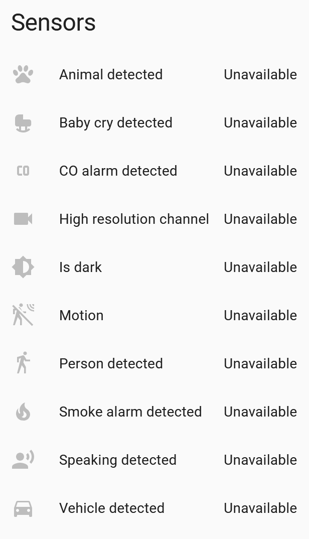

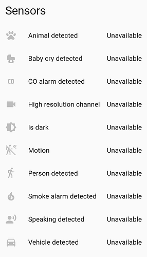

I have a several Unifi Protect cameras integrated with HA via the built-in integration. Something changed where my streams still are visible, but report “This entity is no longer being provided by the unifiprotect integration. If the entity is no longer in use, delete it in settings.” when I view the feed in HA.
Also, the devices report that all of the sensors are currently unavailable, which is breaking some of my automations that relied on those. Anyone else having this issue? I know that Unifi updated its Protect platform recently as well (I’m on 6.1.65), I’m wondering if this is related.

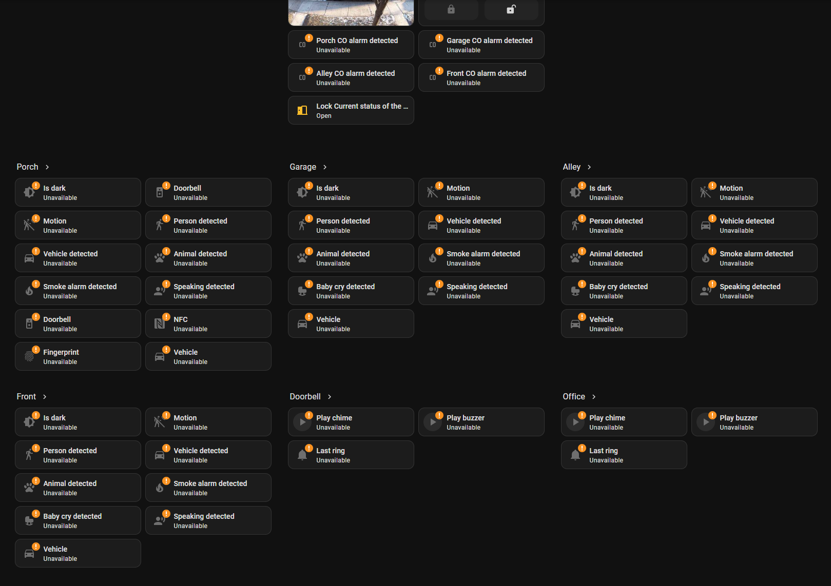

I have a similar thing happening, sometimes I open HA and it is working. But more often than not I open HA and it looks like this:
If I go to integrations and select Unifi Protect and reload it, it comes back fine. But then will randomly go offline again later. This is screwing up my fingerprint unlock automation because it doesn’t get the fingerprint identified notification from Unifi.
