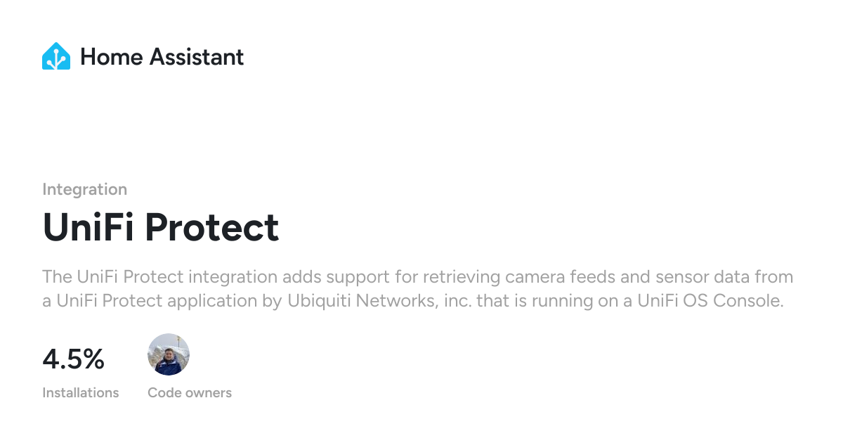

I found the anti reboot safety check in the example provided in the Unifi Protect Integration to be reliable. AND it does not depend on a timer.
