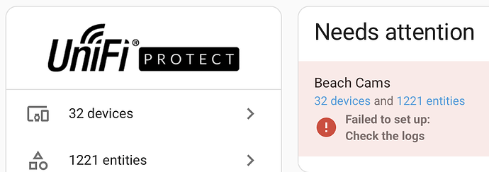

UPDATE: rebooted HA, now getting…
and no data from ANY unifi devices.

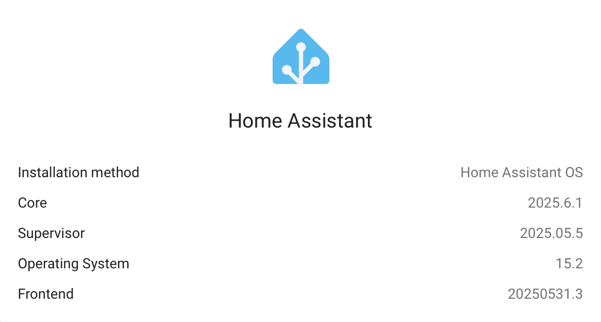

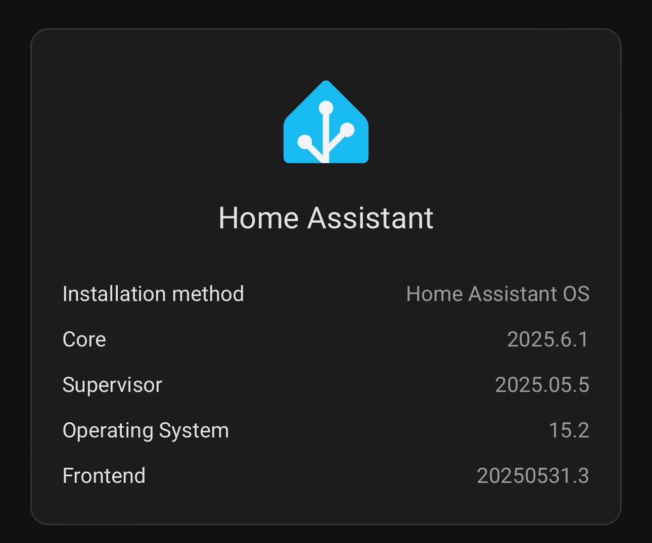

@thomba If you have a second, can you confirm the HomeAssistant OS version that you updated to? I’m having the same errors with Protect 6.0.45 and I believe I’m on the most current HA OS version.

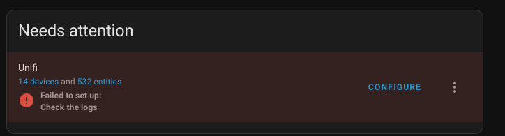

Anyone else receiving the Protect integration error “Failed to set up?” I believe I’m on the most current version of HA OS (see configuration details below) and hopeful that by sharing this information early that it’ll help bring awareness to the potential issues with UniFi Protects upcoming version.

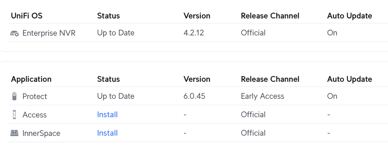

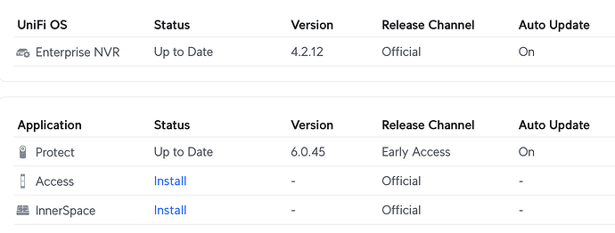

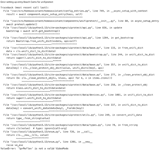

I did not receive that error with Protect 6.0.41 only occurred for me on version 6.0.45. Here is my current configuration(s) and error messages:
Here’s where I’m at…
I’m not running any EA versions. Your 6.0.45 is EA
