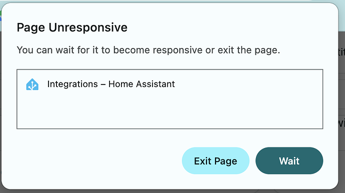

I only have 77 devices on my home Unifi and a few selected noted above, not all. Now it shows 57,000 devices and it will not open. I get a window that says WAIT or EXIT PAGE. Waiting never gets it to an open state to see anything.

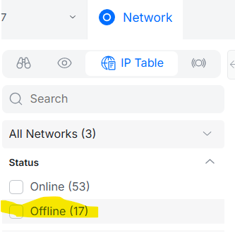

Oh wow, that was quite a lot. Start by deleting the integration. Then you need to look through Unifi, do you have a lot of offline devices listed?

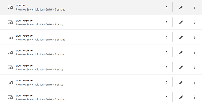

It will populate your integration with all entries in Unifi, even if they don’t exist on your network currently. For example are these entries from different test servers I’ve spun up the last months, they do not exist now. Did you inherit the Unifi controller from work (large network) or something?

It was weird. I had a few thousand show up in my Unifi then after a few days it self purged back to the 4 offline. Why that happened is beyond me doing a reboot on all my Unifi devices and other devices cleared it after a day or so.

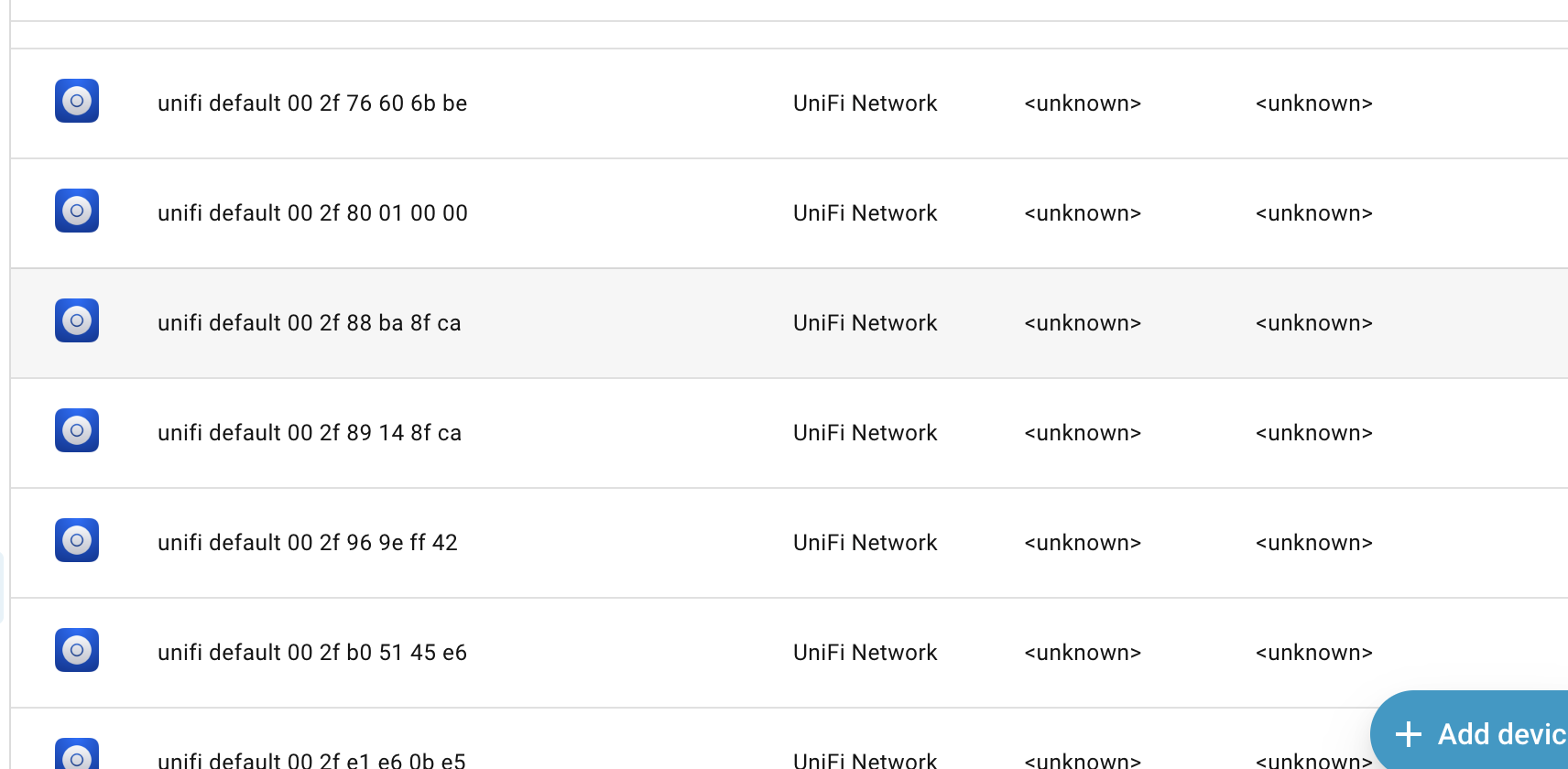

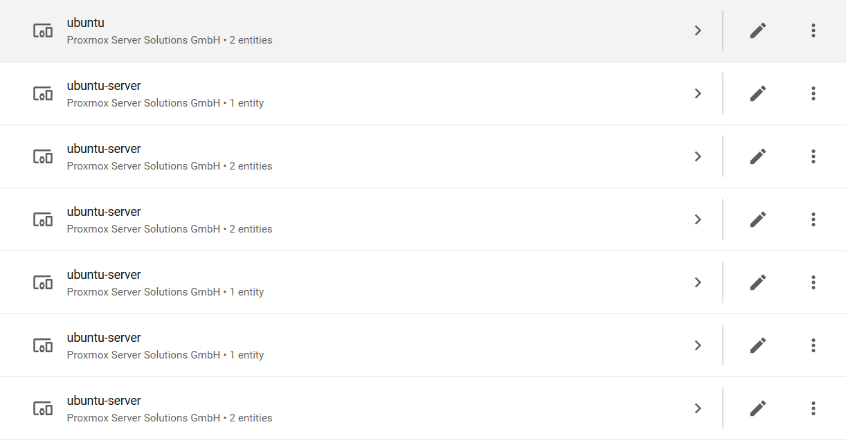

I have thousands of these listed below. I cannot even click on one to delete it although that would be impossible to do if I could. Locks up HA if I select one.
Is there another way to delete an intergration if I cannot click on it directly from Devices?

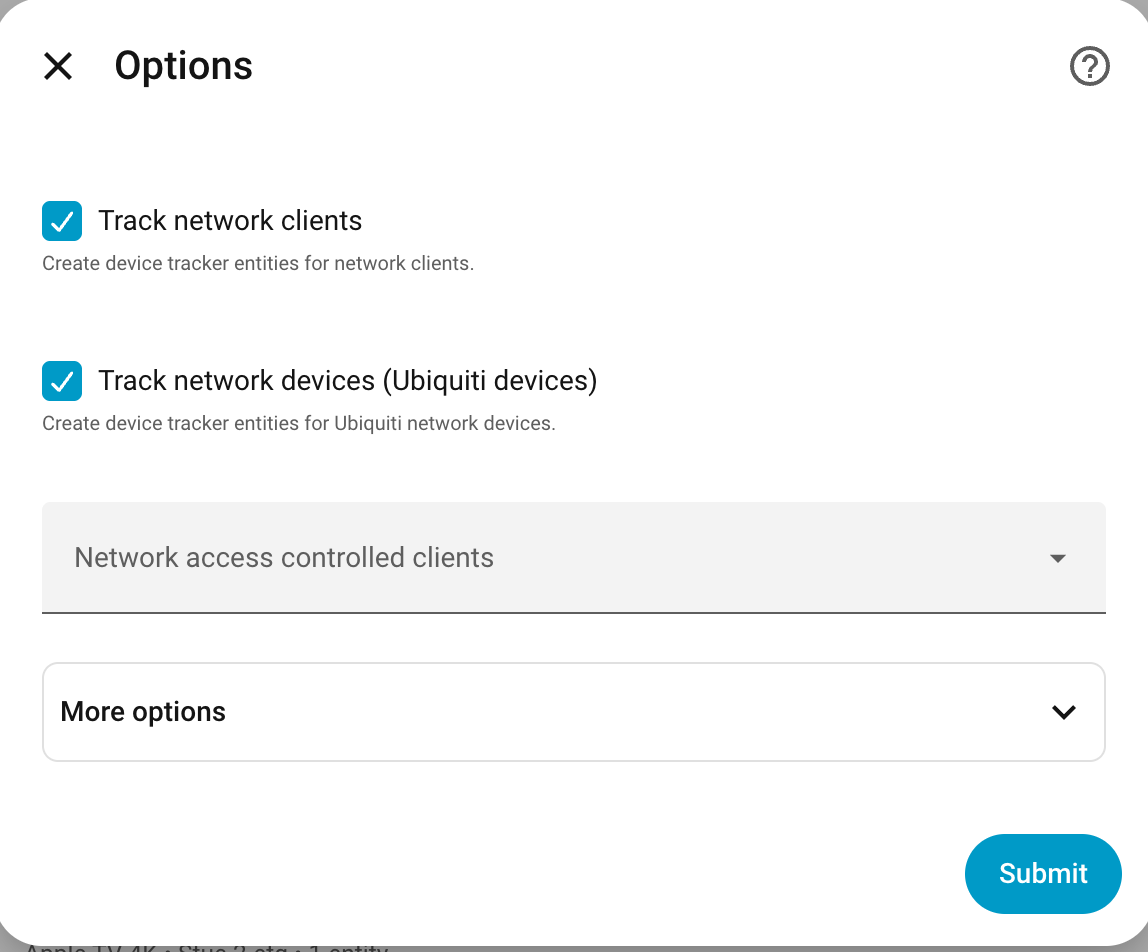

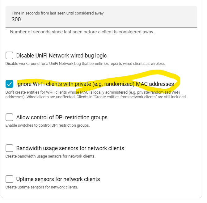

A lot of different MAC addresses, they seem generated. Have you tried playing around in the options of the integration? Or does it time out? There’s an option there to exclude private (randomly generated) MAC addresses, but 57K seems so wrong.

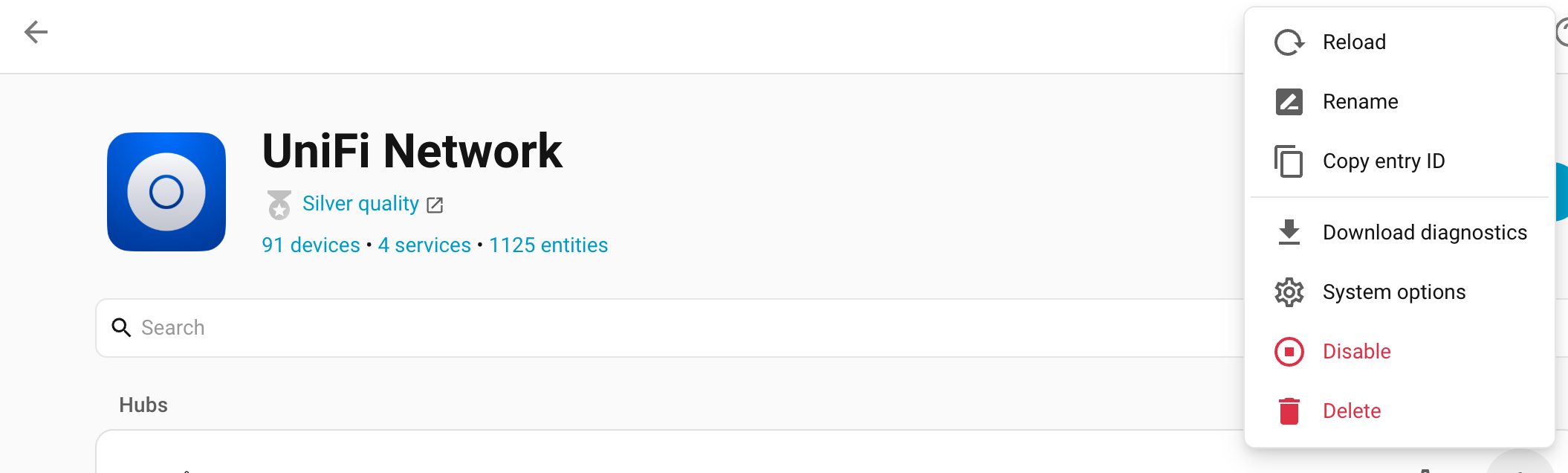

I had the same issue (delete not displaying as an option), but after restarting my browser I could scroll down to delete. Do it from the integration page, not devices.

So I cannot get into the Unifi intergration to even access the option to delete.
Settings >> Devices & Services >> Intergration seen below like my first post. I assume since it is so many devices I will not cache to open. I keep getting the window to WAIT or EXIT waited over 30min and still did not open. Ran so long that my MacBook Pro M5 fan begins to run. I never hear the fan on my MBP M5.

If you have devices that you control that are set to generate random mac addresses (usually touted as some kind of privacy setting on wifi), it can also cause a large number of unused clients on the network and they’ll show up in the integration.
Also, if you spin up virtual systems with networking, those may be creating random mac addresses as well and also creating a number of old clients that aren’t reused.

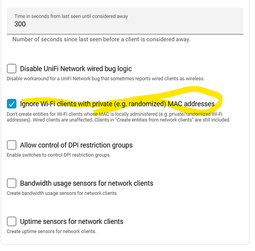

@fleskefjes what option name or selection to keep it from generating random mac addresses?
Yes, that is correct. Deletions in Unifi does not delete in HA.
Under “more options”:
@fleskefjes @VietNgoc

I need to readd it so do as you posted to ignore random Mac Addresses
