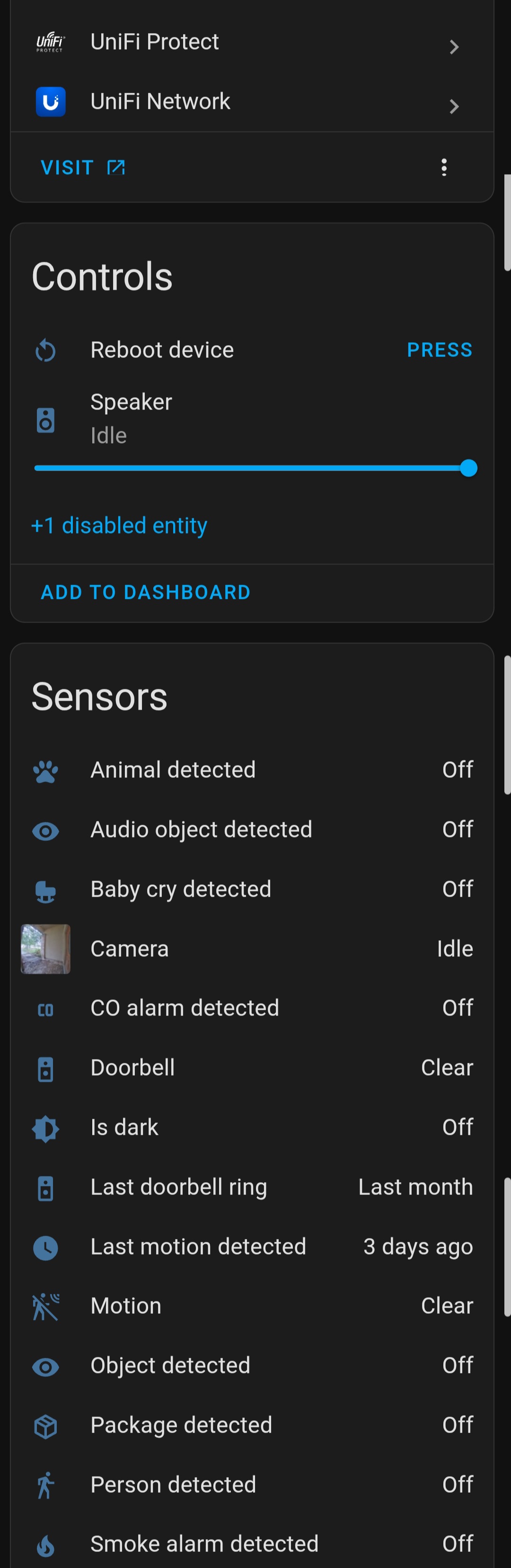

Settings. Devices and services > unifi protect > devices.
Should show your camera it will look something like this

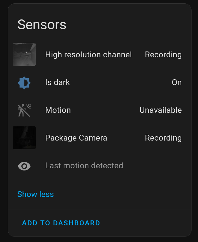

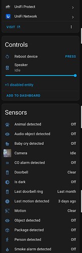

ahhh cool yep, been staring at this page most of the evening there is just nothing there actually called entities is what confused me. so what section should the button be under? i assume controls , I only have reboot device and unadopt device under controls.
Show hidden and it’s under sensors. You don’t control you read it.
cool, thanks, here is my sensors for the camera, I clicked the +1 entity not shown, is that what you mean by hidden?
For me, it’s binary_sensor.doorbell_doorbell
Where doorbell is the name of the device.
It would appear you might need to click on the motion one and enable it. Not sure where the button is.
I would suggest restarting home assistant to see if it picks it up on a restart after you enable motion.
dis abling and enbling motion did it, over about 20 minutes more “entities” appeared in the sensors box. i can now see “Doorbell” !!! yay

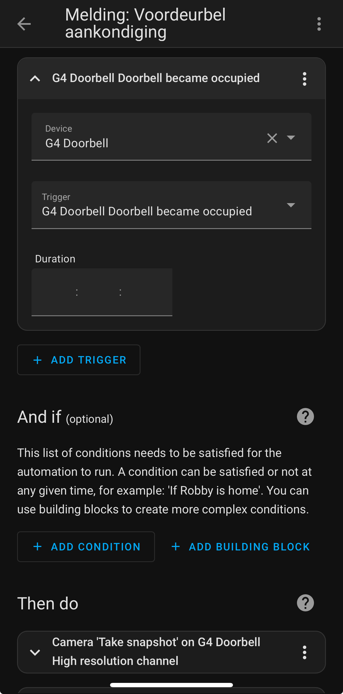

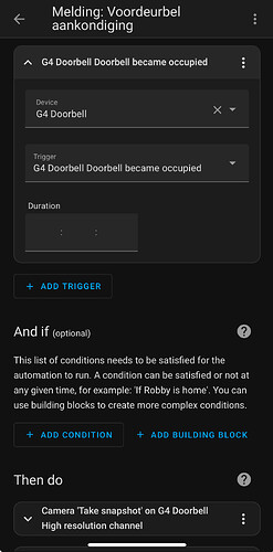

I was looking for same thing. Ended up with.
I use action “ when occupied”
Than snapshot and show on media player tv.
So use this action “occupied” to trigger what you want.
yes! thanks i have when occupied, the door bell can now toggle the state of the LED on the H100 as there is no chime entity. well im way closer than i ever thought i would be on this lol. if I go to settings on the chime h100 thing I can set the chime off from controls. but nothing in entities. thanks realm
