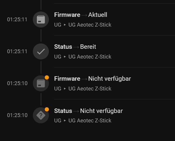

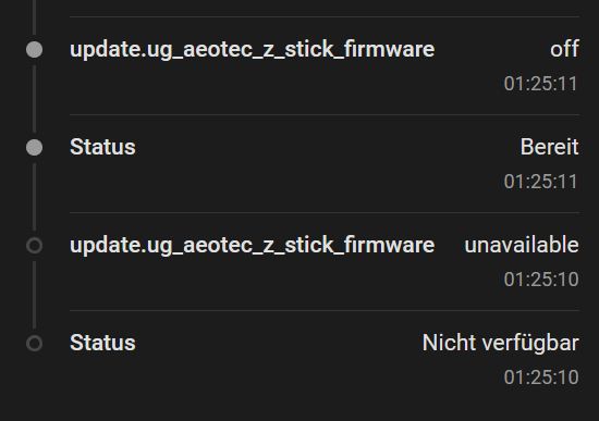

I just found something: my Aeotec Gen5 Z-Wave USB stick apparently checked for or requested a firmware update at exactly that time. I’m not sure which, please see the screenshot. At that precise moment, all the wall switches suddenly became active; essentially, if you disable and then re-enable a wall switch in Home Assistant, exactly the same thing happens …
I’ve disabled the firmware entity on the Z-Wave stick for testing purposes curious to see how it goes.
It looks as if the stick was searching for a firmware update and then restarted or so I suspect. I’m not sure if disabling the firmware entity actually achieves anything…
