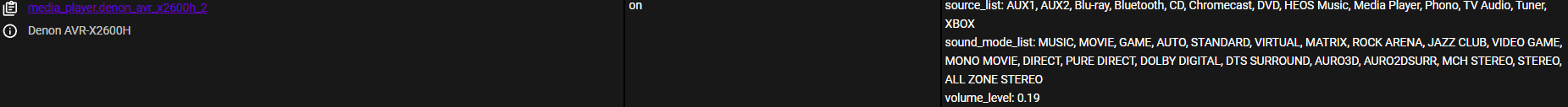

as a sanity-check, the media player does provide the sound_mode_list:

here is the attributes list of the new unified media player:
is_volume_muted: false
source: HEOS Music
sound_mode: MCH STEREO
device_class: receiver
friendly_name: Denon Uni
supported_features: 3080125
source_list: Skai FM, Alpha 98,9 98.9 (Greek Music), Pepper 96.6 (Easy Listening), 87.7 | En Lefko (House), Best 92.6 FM | (Adult Hits), NRG 95 95.0 (Adult Hits), Music 89.2 | (Top 40 & Pop Music), Love 97,5, Galaxy FM 92.0 (Greek Music), 92.9 Kiss | (Top 40 & Pop Music), Athens Deejay FM 95.2 (Adult Hits), Radio Sfera 102.2 (Top 40 & Pop Music), Lampsi 92.3 | (Greek Music), Rythmos, Chromecast, DVD, Blu-ray, XBOX, AUX1, AUX2, Media Player, CD, Tuner, TV Audio, Phono
group_members: null
volume_level: 0.19
media_content_id: 2068574838
media_content_type: music
media_title: Me Ta Matia Na To Les
media_artist: Giorgos Mazonakis
media_album_name: Me Lene Giorgo / Part One (1993-2002)
shuffle: false
repeat: off
active_child: media_player.denon
entity_picture: http://10.0.110.3:8015/local-server/albumart/61913df7197bba293a1f8c7107382999
media_duration: 0
