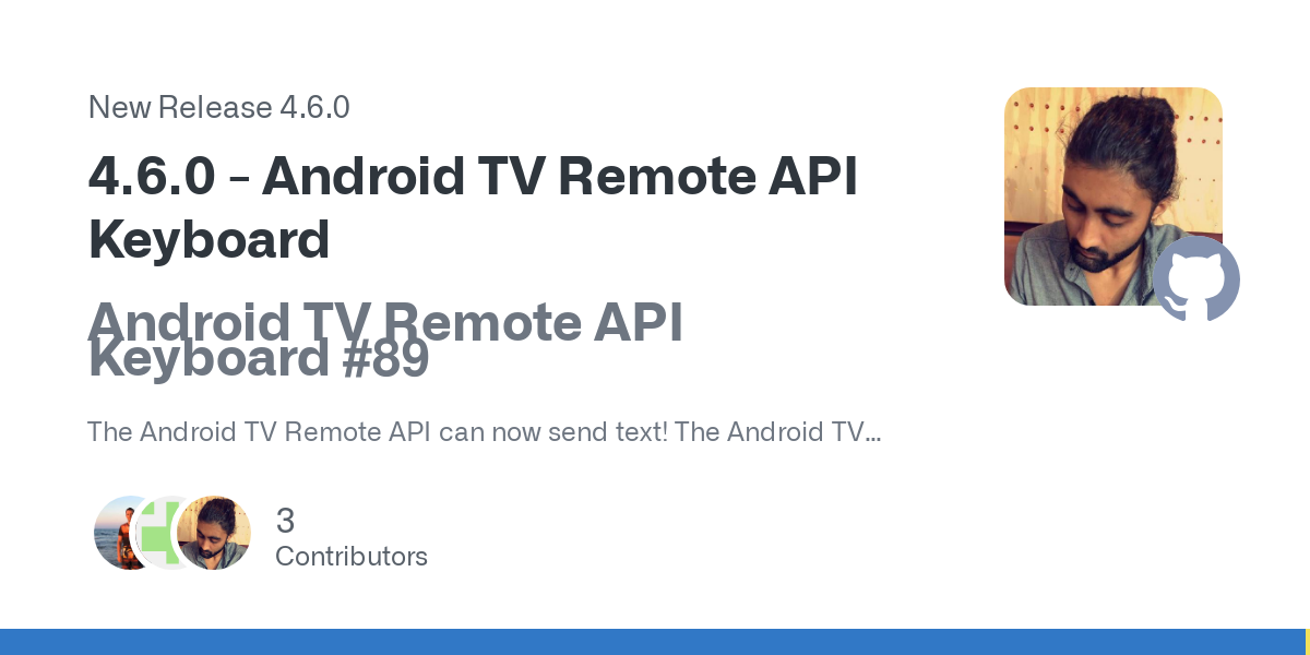

Version 4.6.0 has one big feature - the Android TV keyboard no longer uses ADB. Huge thanks to @astrokin for reverse engineering sending text via the Android TV Remote API and @tronikos for adding a way to use this new method via Home Assistant actions. You’ll no longer see the Keyboard ID field for most platforms as it is redundant and no longer needed.
You can still use the old ADB keyboard and search methods by creating a custom element keyboard/textbox/search action with the platform Fire TV.

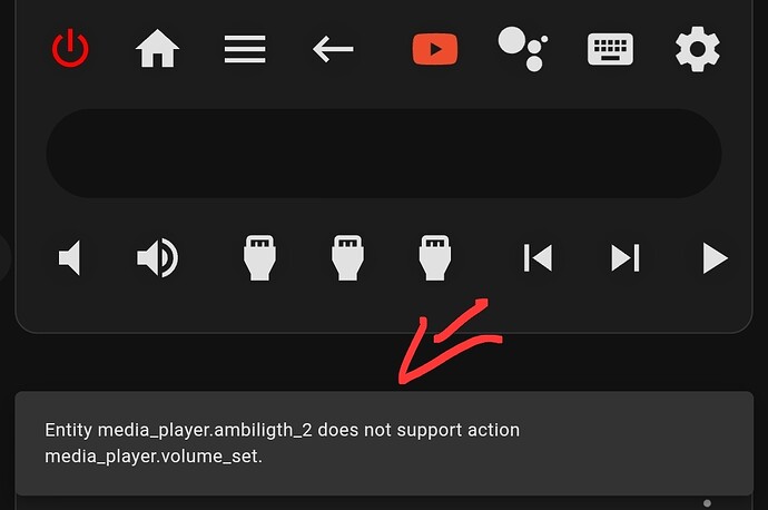

Hello, I get this error when trying to use the Slider! How can I solve it?
I have a PhilipsHue Android TV
That’s telling you the volume function doesn’t work with your specific device.
What integration did you use to add the ambiligth_2?

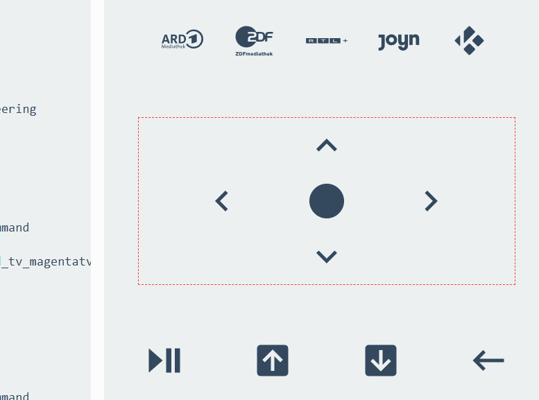

What a fantasic card. I’m on the the way to exchange my Logitech Harmony with an old smartphone with this card.
I would like to have a different color behind the navigation buttons, anyone knows the css for this?
In the editor preview hover over the navigation buttons such that all of them have a red outline like in your screenshot but wait until the column ID selector appears as a tooltip, and then use that to add a background with the general CSS styles field.
#column-1 {
  background: var(--input-background-color);
  border-radius: 9999px;
Thanks a lot. I saw the tooltip before, but did not know there is a general CSS styles field.
Works as expected, keep on the fantastic work and many thanks for the support!

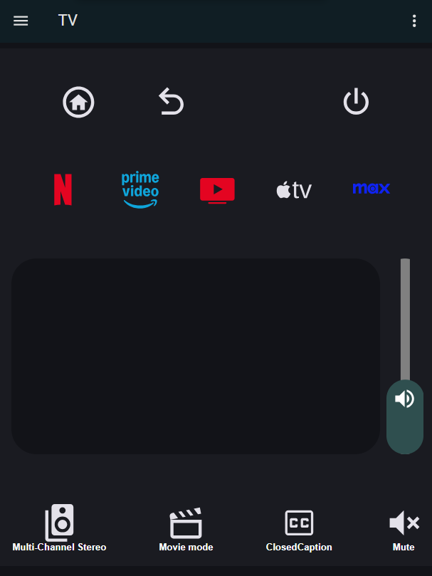

What a well-designed card! Took a while to figure out syntax, but now I have my Logitech Harmony Hub working with my Vizio SmartCast TV, along with a Denon receiver.
I couldn’t find any examples of this combination, so here I submit my 300 lines of YAML, in the hope it inspires someone else.
Great work!

You used the card configuration UI right? It makes setup much easier. FYI Material You theme works best when you set it at the user level (not in the view or card) with the companion Material You Utilities module.
Only recently discovered how comprehensive the config UI is; still experimenting with styles & themes. Lots of examples for these. Thanks!
