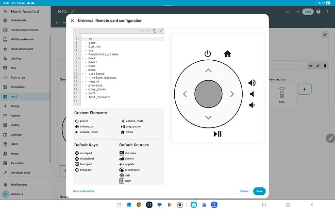

I’ve been building a remote using the generic remote template as I’m building a controller for multiple remotes.
Overnight most of the default keys have disappeared. The code is still there, it just isn’t pulling icons into the layout eg rewind.
My HA image updated yesterday so I don’t know if that’s the issue. I’m not very experienced so the chance of human error is pretty high but if anyone can help me out it would be appreciated
My bad, I broke the generic remote platform. Fixed in version 4.9.2.
