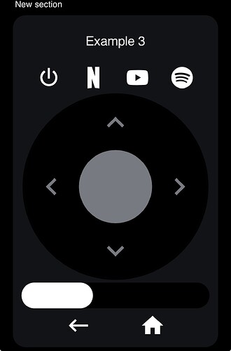

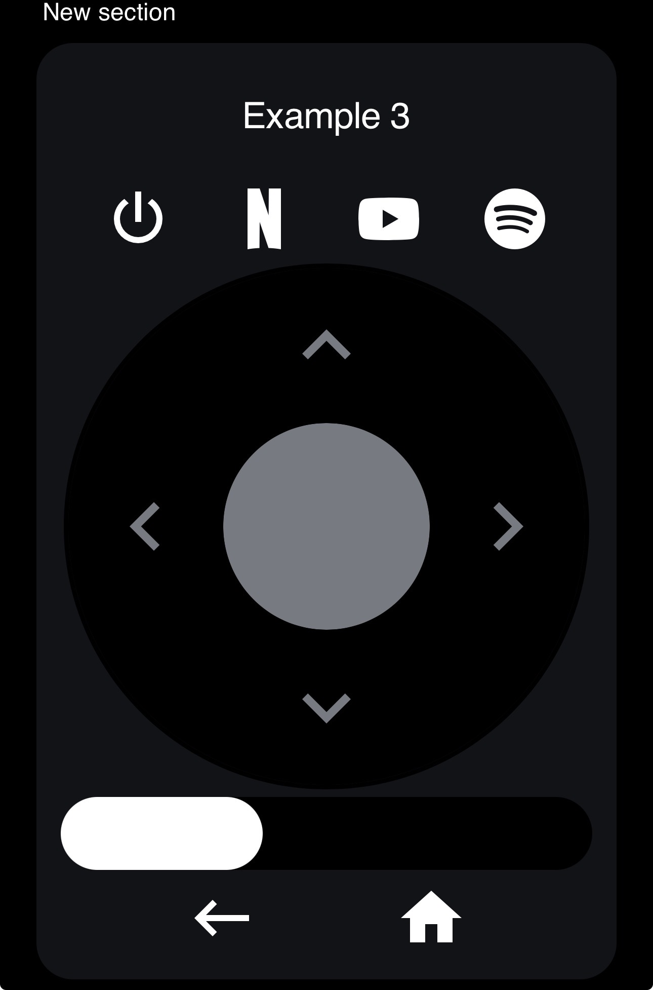

When using the slider with Fire TV and selecting the media player (JBL Bar 1000), the volume slider does not retain its position. After changing the value and tapping anywhere on the screen, the slider jumps back instead of staying at the selected level.
Also i have tried to use the jbl number entity directly but got the same behavior
Are you sure that the sound bar reports it’s volume back to Home Assistant? What does the media player volume_level attribute look like? Does it actually change the volume? A lot of media player entities do not actually report their volumes or support the media_player.volume_set service.
Thank you for your reply :pray:t4: Yes it actually changes the volume even through the card it just that the slider doesn’t stays at the set position after changing the volume, it jumps to a different position without effecting the volume level with that behavior
Post your slider config, something may be wrong with that. When you refresh the page is the volume slider in the correct position? It could be that the soundbar takes a while to report it’s updated volume to Home Assistant and the slider’s update after action delay needs to be increased to account for it.
I tried using the number entity provided directly by the soundbar, but the issue still persists. When I change the volume to any value and then tap anywhere on the dashboard, the slider immediately jumps to the maximum. After refreshing the page, it resets to 0, even though the actual sound volume remains correct and continues working properly.
I tested both the media player entity and the number entity, and I also adjusted the delay interval to multiple values, but none of these changes resolved the issue
type: slider
range:
  - 0
  - 100
step: 1
value_attribute: volume_level
tap_action:
  action: call-service
  service: number.set_value
    entity_id: number.jbl_bar_1000_c3d8_volume
    value: '{{ value | int }}'
vertical: true
value_from_hass_delay: 10000
You left the media player volume_level value_attribute field in so the feature’s value is undefined. You need to delete that line to use the feature with the number entities. For media player volume level, the range is 0 - 1 with a step size of 0.01.

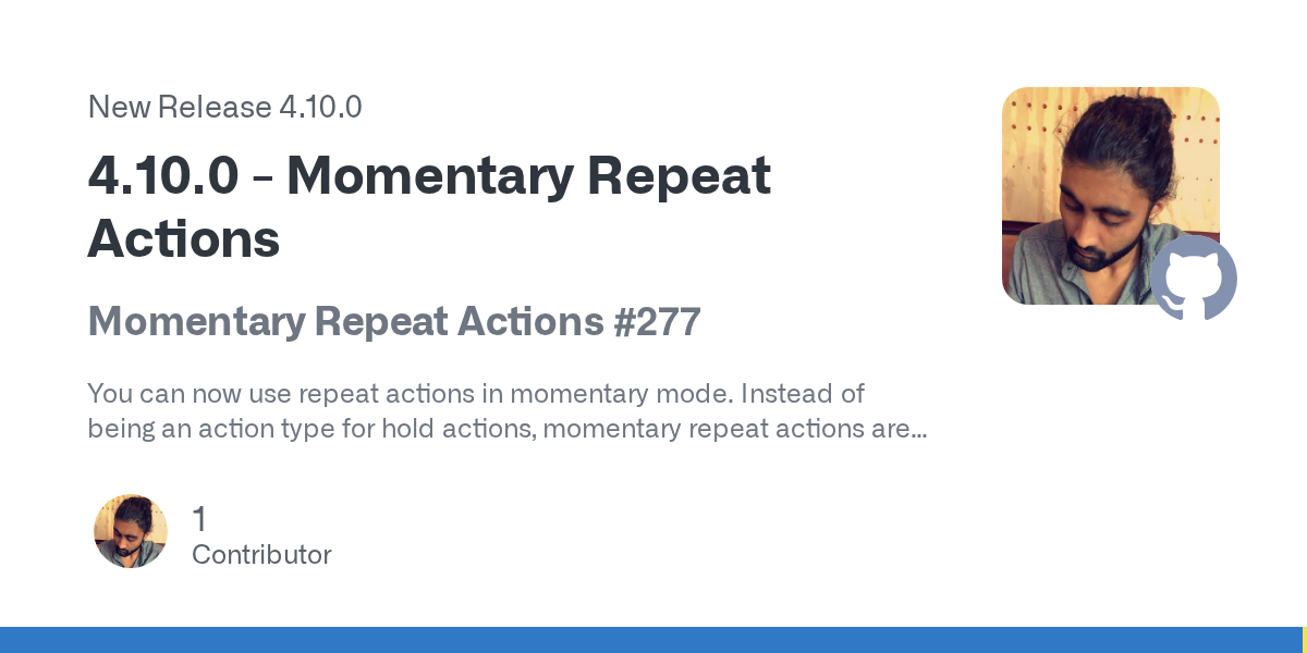

Version 4.10.0 adds momentary repeat actions. You can now fire different actions when initially pressing, holding on repeat, and then releasing a button in momentary mode.
