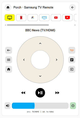

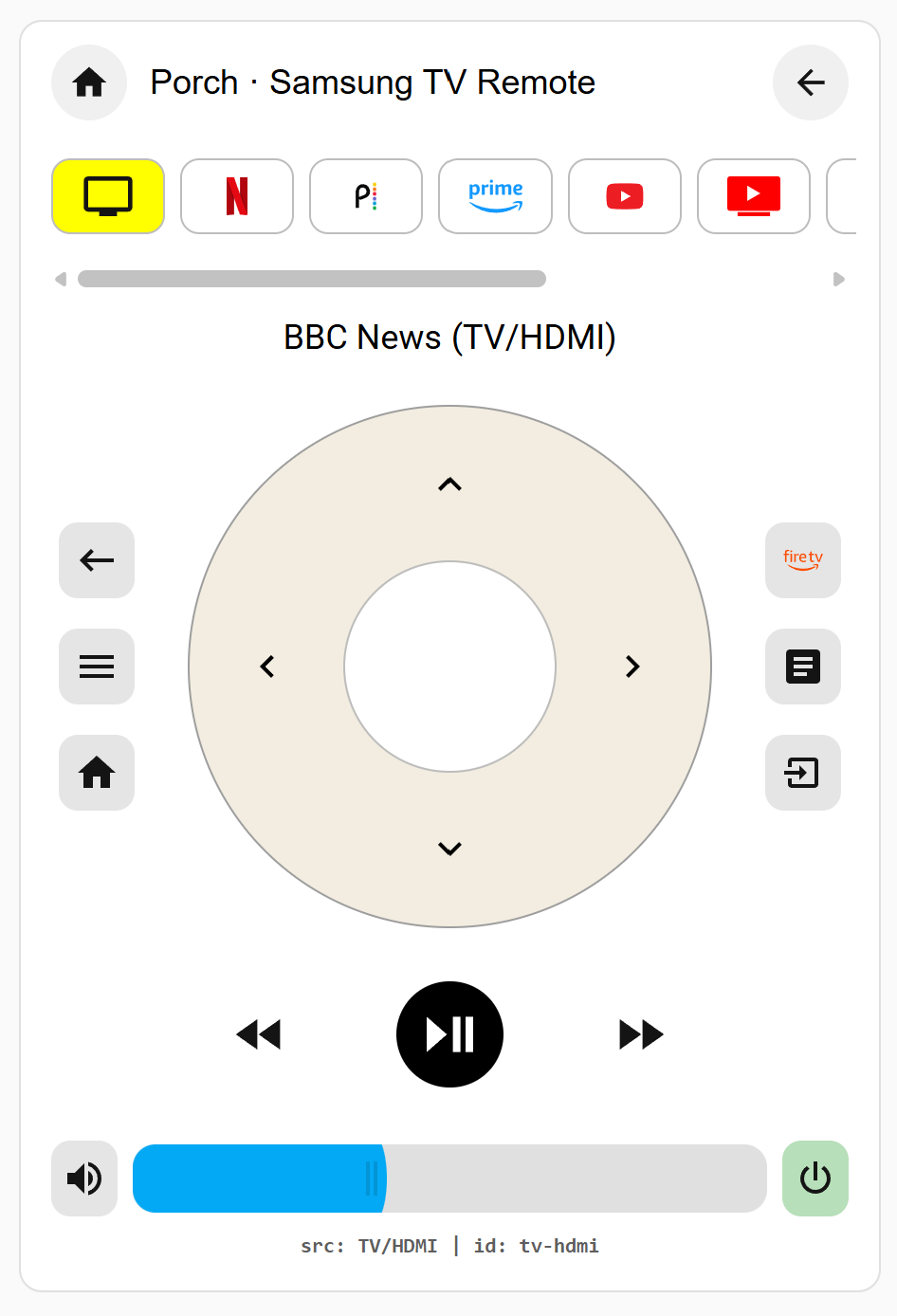

I am controlling several different TV’s (One Samsung [Smart TV Mode], One Samsung, fed by a Fire TV streamer, and an LG, fed by a Fire TV streamer).
90% of the dashboard yaml is identical.
I just fill in the entities and point to a custom_actions_file that holds all the app commands etc…
So the Samsung + Fire TV is:
 - type: custom:universal-remote-card
        platform: Fire TV
        remote_id: remote.fire_tv_family_192_168_1_65
        media_player_id: media_player.fire_tv_family_192_168_1_65
        volume_entity: media_player.ma_soundbar_porch
        power_entity: media_player.sts_samsung_q90_porch
        mute_entity: media_player.sts_samsung_q90_porch
        room_name: Porch · Fire TV Remote
        custom_actions_file: local/ur_firetv.yaml
and the Samsung Smart TV version is:
        platform: Samsung TV
        remote_id: remote.sts_samsung_q90_porch
        media_player_id: media_player.sts_samsung_q90_porch
        room_name: Porch · Samsung TV Remote
        custom_actions_file: local/ur_samsung.yaml
and the stylized remote is (100% URC):
Happy to share full dashboard yaml and the custom_actions_file if it helps anyone.

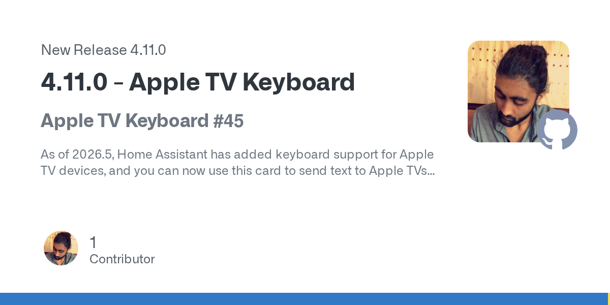

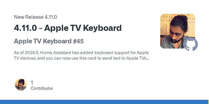

Version 4.11.0 adds keyboard support to the Apple TV platform, along with a few other small improvements. This release requires Home Assistant 2026.5.0, which adds keyboard actions to the Apple TV integration.

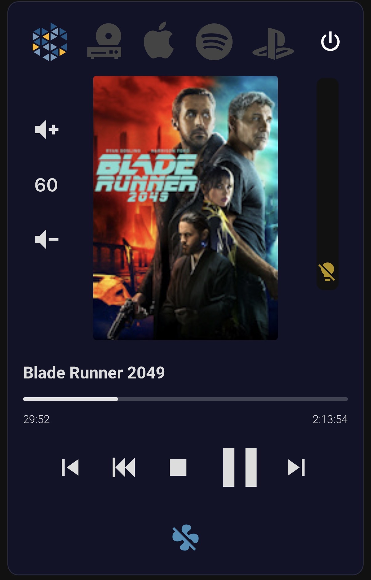

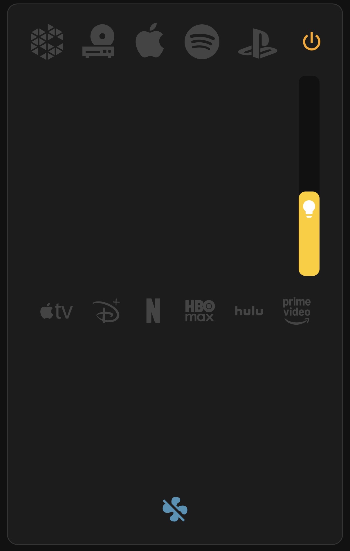

I love the Universal Remote Card! I have three TVs, use a streamline card holding the URC and some other entities (on/off for the speakers and volume control, art_mode, brightness, etc) and one button access to all of our (too many) subscriptions. I put those cards behind conditional cards, so that they don't clutter my dashboard when not in use. Fantastic! Thanks, Nerwyn!
Just wanted to drop in and express my appreciation for this awesome card. @Nerwyn, thank you for the effort in both creating it and for publishing such a comprehensive readme. There’s a mountain of knowledge in there if you’re willing to go look for it, and the examples seemed to be very thoughtfully assembled to cover the gamut in terms of adjustable parameters. I started with zero experience using CSS templates, so I was pretty happy to be able to create a universal remote for my theater that does a somewhat decent job of imitating the native appearance of the individual components and apps.

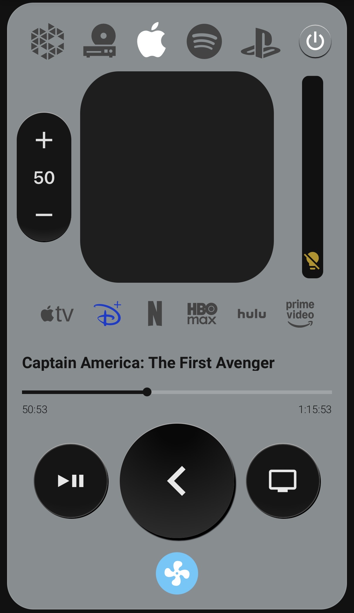

I do have a couple questions that I wasn’t able to run down, if anyone happens to know. Does this card accept the following template?
{{ states.media_player.apple_tv.attributes.media_duration is defined }}
I’d like to be able to suppress the slider for media position when it’s obviously not relevant, and the above seems to check ok in the template editor, but no luck using it in the layout section of the card. I’m also struggling to define a fixed height for a row that holds single icons or columns depending on input source. I’ve tried
#row-8 { height: 100px; } as an example in the general styles as well as .row {height…} in individual elements. I’m sure I’m missing something simple here.
I’m glad you like it so much! Your remotes look excellent.
This card (and custom card features) use an alternative frontend templating system I developed called ha-nunjucks, which has mostly the same syntax with some minor differences. One of them is the syntax of the states object, as I can’t use the same name for it and the states function. You just have to add an underscore before states.
{{ _states.media_player.apple_tv.attributes.media_duration is defined }}
BUT you should avoid using the states object directly in favor of the state_attr function, which is much more efficient.
{{ state_attr('media_player.apple_tv', 'media_duration') is defined }}
To change an individual row height, unset its flex property so it doesn’t conform to its parent flexbox.
#row-8 {
  height: 100px;
  flex: unset;
Ah thanks, that did it!

        entity_id: remote.dining_room_xbox_one
        command: Pause
      hold_action:
        action: nothing
    type: pause
  - name: menu
    icon: mdi:microsoft-xbox
    tap_action:
      action: call-service
      service: remote.send_command
        command: Nexus
    type: menu
  - name: plex
    icon: mdi:plex
    tap_action:
      service: media_player.play_media
        entity_id: media_player.dining_room_xbox_one
        media_content_id: 9NBLGGH3ZZVF
        media_content_type: app
    type: plex
  - name: youtube
    icon: mdi:youtube
    tap_action:
        media_content_id: 9NDP7KTLK7W3
    type: YouTube
  - name: volume_up
    icon: mdi:volume-plus
    tap_action:
      service: media_player.volume_up
    hold_action:
      action: repeat
    type: volume Up
  - name: volume_down
    icon: mdi:volume-minus
    tap_action:
      service: media_player.volume_down
    hold_action:
      action: repeat
    type: volume down
  - name: volume_mute
    icon: mdi:volume-off
    tap_action:
      service: media_player.volume_mute
    type: volume mute
  - name: back
    icon: mdi:arrow-left
    tap_action:
        command: GoBack
    type: back
  - type: rewind
    icon: mdi:rewind
    tap_action:
        command: Left
    hold_action:
      action: nothing
  - type: fast_forward
    icon: mdi:fast-forward
    tap_action:
        command: Right
    hold_action:
      action: nothing
  - type: Next Chapter
    icon: mdi:skip-next
    tap_action:
        command: Next
  - type: Previous Chapter
    icon: mdi:skip-previous
    tap_action:
        command: Previous
