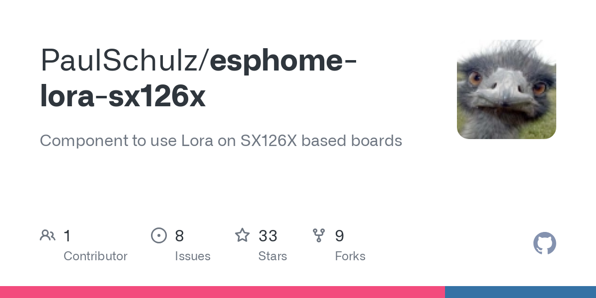

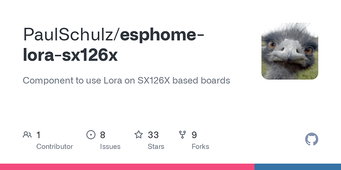

or lora
https://es.aliexpress.com/item/1005006115124387.html
aliexpress.com/item/1005009103014298.html
