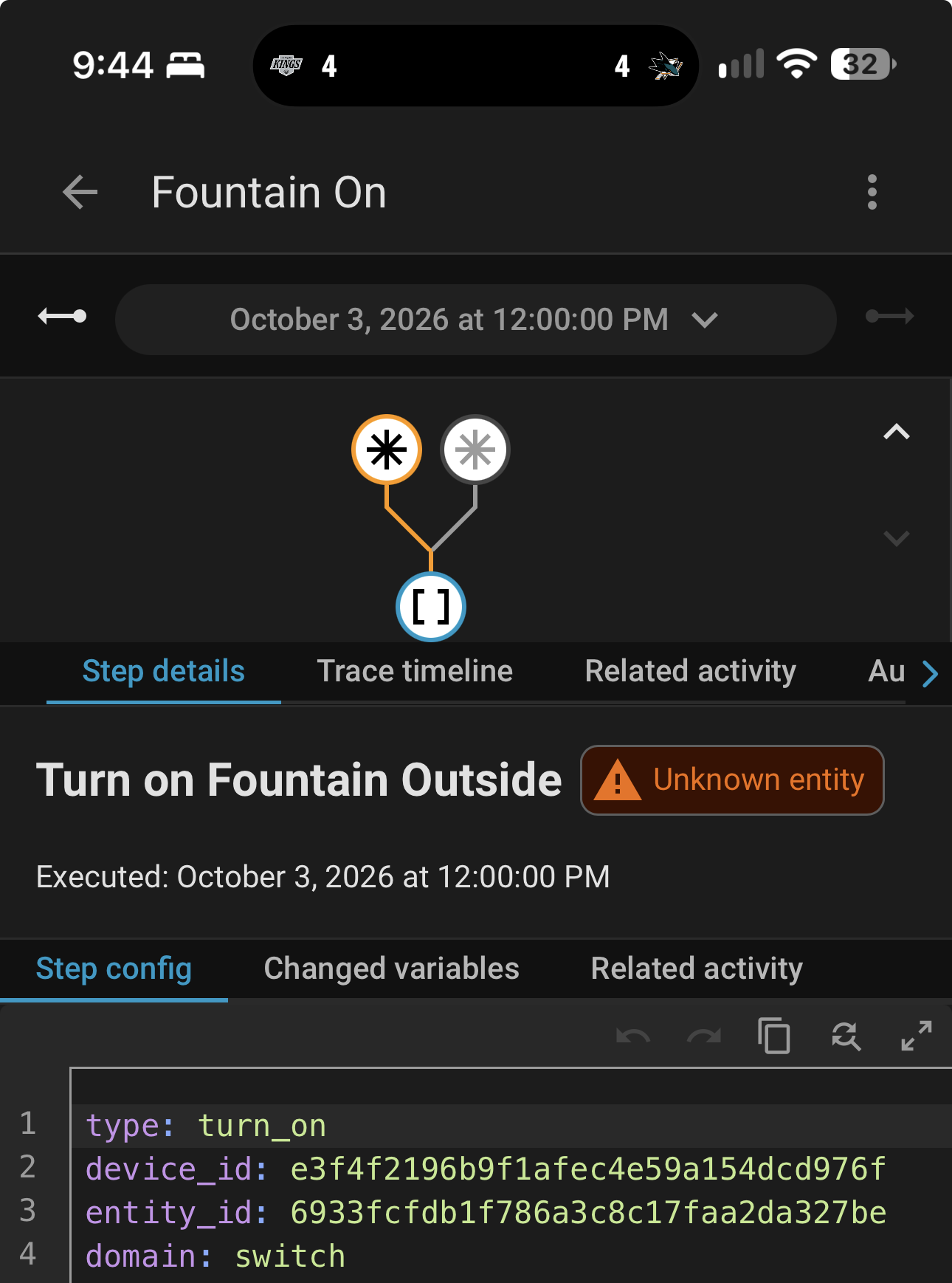

My Automation isn’t working. The switch turns on fine but when my wife said the fountain isn’t turning on, I found this when I went into traces. Do I need to delete the automation and start over?
You don’t need to delete the automation. Repair it. Right now, the turn on action can’t find the selected entity “Fountain Outside”.
I would stop using device_id, start using entity_id. Why and how to avoid device_ids in automations and scripts

It works now.
action: switch.turn_on
metadata: {}
entity_id: switch.fountain_outside
data: {}
