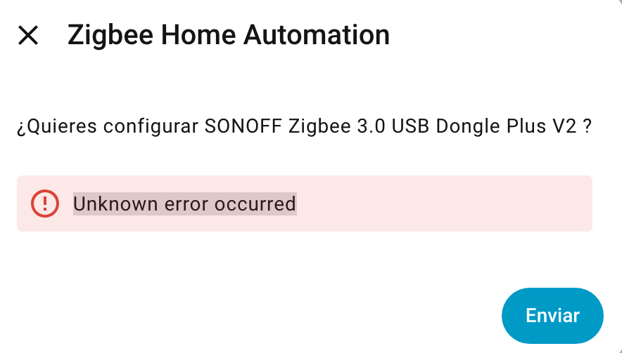

Unknown error occurred
I updated Home Assistant OS to version 17, but my Sonoff Zigbee dongle stopped working. So it seemed easier to delete it and set it up again, but I’m getting the same error.
this is the log

Seems you might have a corrupt database.
yes I think so
If you are running a device with an SD card, updates are a prime time for them to fail because of the large swap of data.
