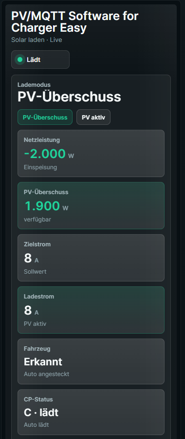

What it does:

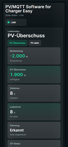

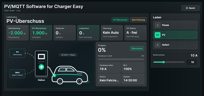

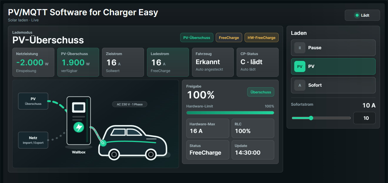

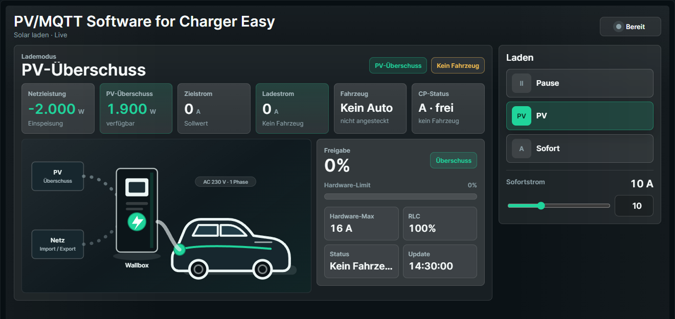

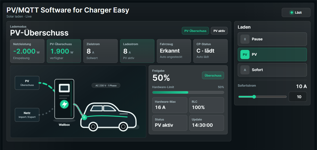

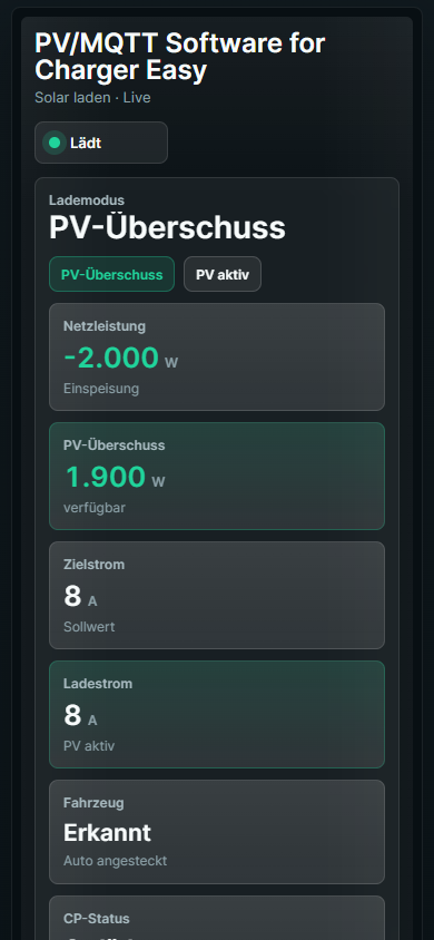

  • publishes Home Assistant MQTT Discovery entities
  • provides a local web dashboard
  • supports off, instant and PV surplus modes
  • reads grid import/export power from Home Assistant
  • calculates PV surplus charging current locally
  • keeps the existing hardware current selector and RLC limits active
  • reports CP state, vehicle connected, effective current, target current,
    FreeCharge override and stale PV data
Hardware:
  • Raspberry Pi (of the Juice Charger Easy; already part of the system)
    including:
    • MCP41xxx digital potentiometer, tested around MCP4161 behavior
    • Juice Booster Easy / Juice CHARGER Easy control board
    • GPIO/SPI wiring for CP state, current selector, DIP switches and RLC inputs
Home Assistant sees the charger as an MQTT Discovery device with a mode select,
instant-current control, current/power sensors and binary sensors.

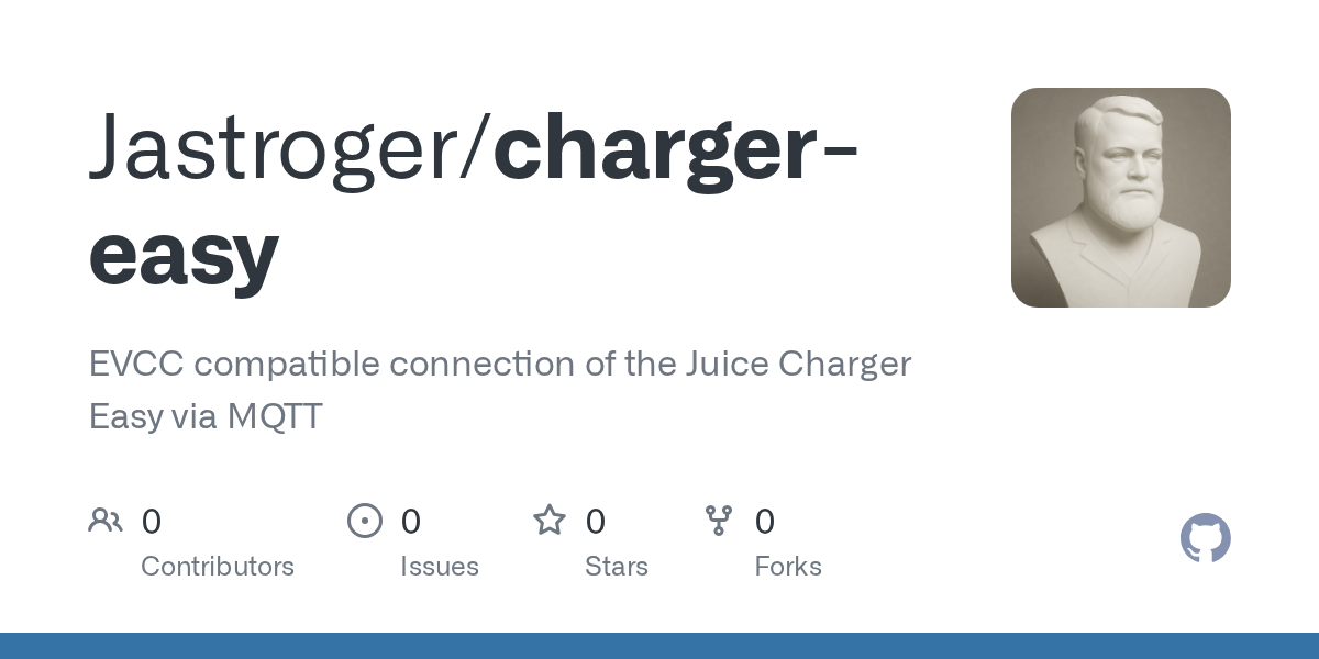

GitHub:

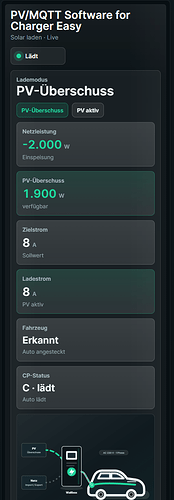

Screenshots:
