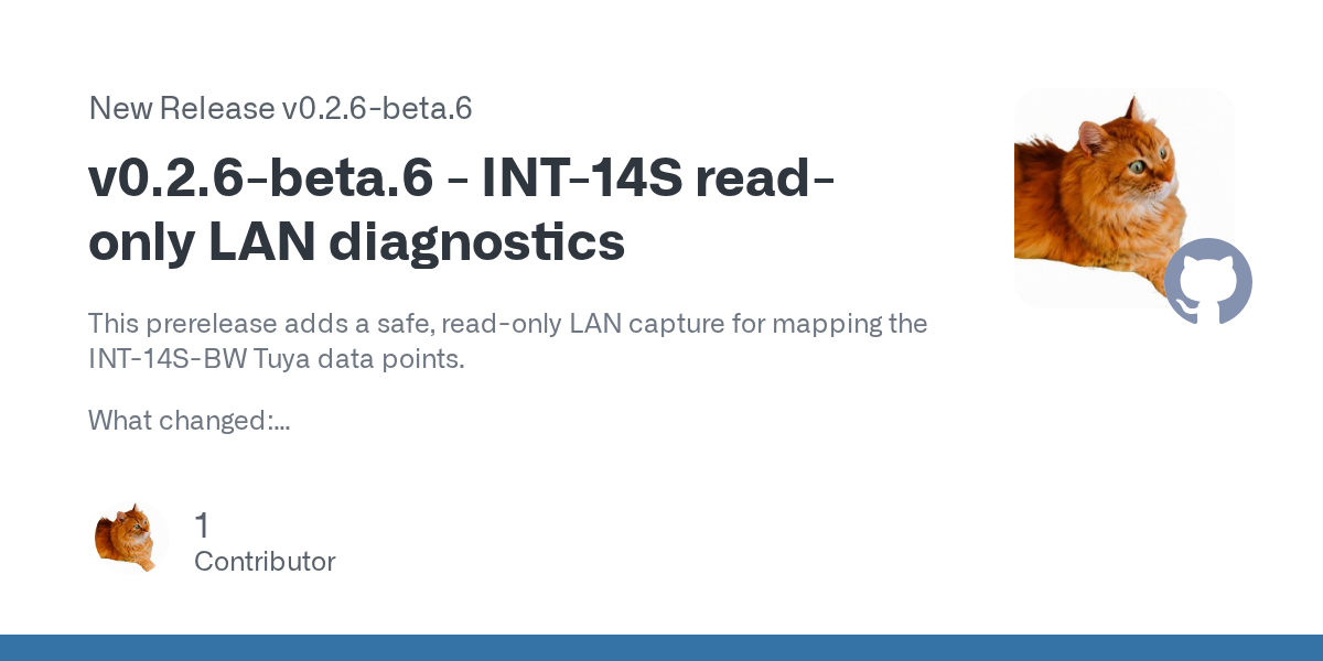

I have prepared v0.2.6-beta.6 specifically for the next step:
Could you please:
  1. Install beta.6 through HACS and restart Home Assistant.
  2. Reconfigure the integration and make sure the selected profile is INT-14S-BW , not INT-14-BW .
  3. Keep the same host, device ID, local key and protocol version.
  4. Press Capture Read-Only LAN Diagnostics .

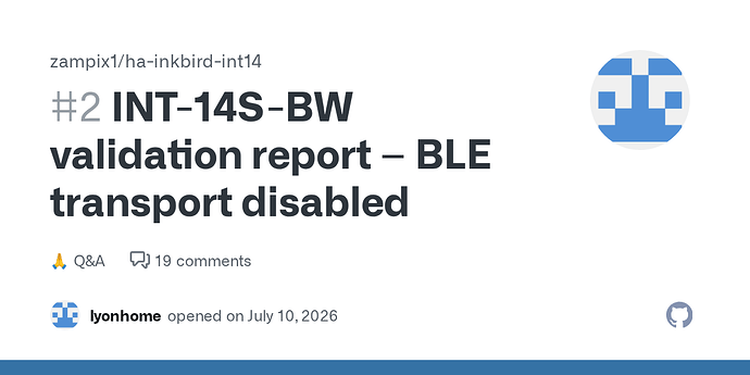

  5. Download the integration diagnostics and attach the sanitized JSON to the existing INT-14S discussion:
The diagnostic sends only status and DP refresh queries. It does not apply the strange values to your entities and does not send setting writes.
The credentials should be redacted automatically, but please still check the file before uploading it
