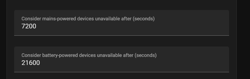

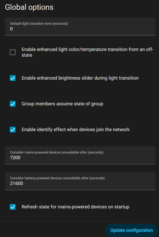

Does your Xiaomi sensor always come back online, now that you changed your coordinator? Also, what does your ZHA integration settings screen show under “Consider battery devices unavailable”?
You are probably referring to the one shown in this image.
Thank you for your efforts to help.
