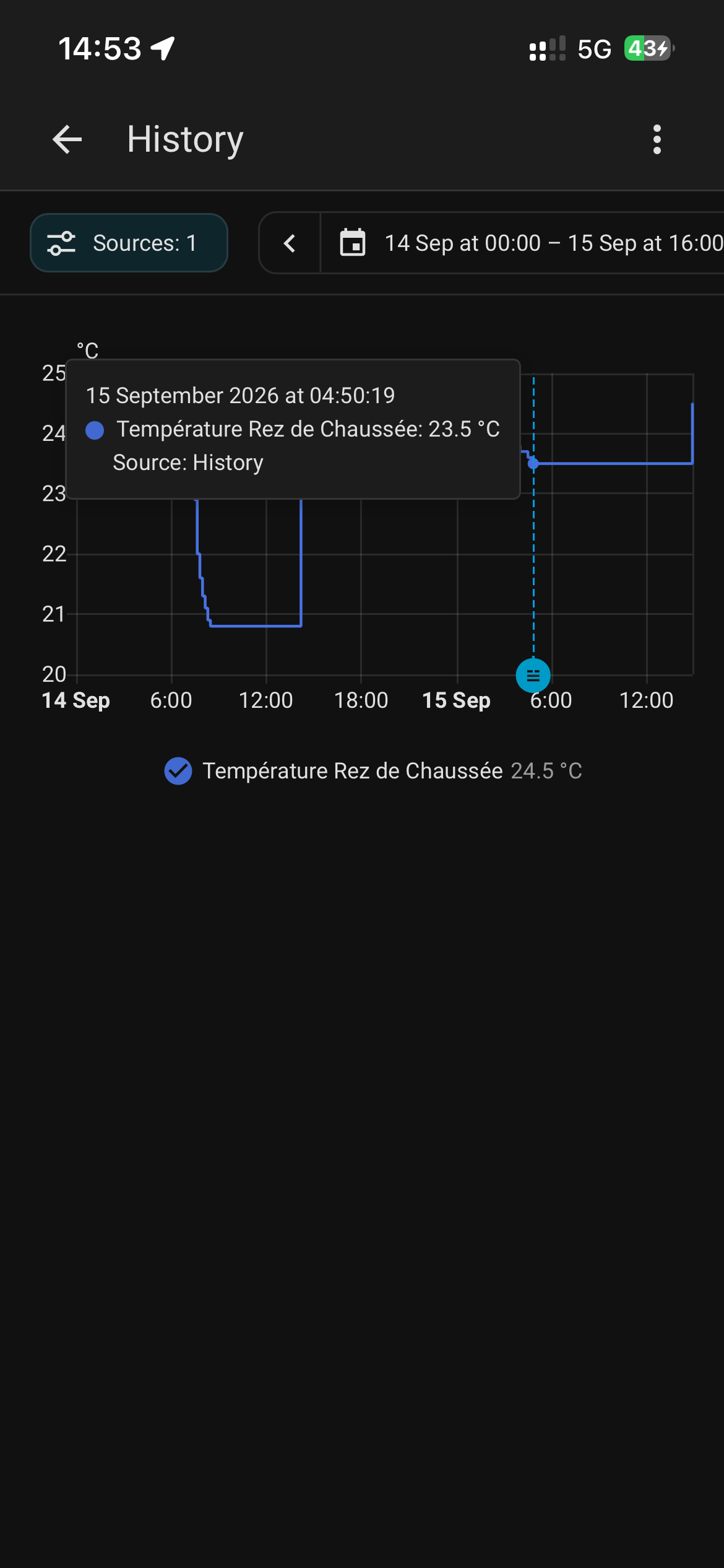

Overkiz integration is also down, no data since 4:50am:
