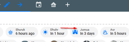

@joohann Thanks very much for this thread! Do you mind sharing the UI cards or setup, how to have the same setup? Thanks very much!
I Forgot, I use chim tts!

Dashboard
type: grid
cards:
  - type: tile
    entity: sensor.hijri_date
    color: green
  - type: tile
    entity: sensor.imsak_readable
    visibility:
      - condition: state
        entity: sensor.next_prayer
        state: No upcoming prayer
      - condition: state
        entity: sensor.is_ramadan
        state: "true"
    features_position: bottom
    vertical: false
  - type: tile
    color: blue
    vertical: false
    visibility:
      - condition: state
        state_not: No upcoming prayer
      - condition: state
        state: "true"
  - type: tile
    entity: sensor.fajr_readable
    color: accent
  - type: tile
    entity: sensor.dhuhr_readable
    color: accent
  - type: tile
    entity: sensor.asr_readable
    color: accent
  - type: tile
    entity: sensor.maghrib_readable
    color: accent
  - type: tile
    entity: sensor.isha_readable
    color: accent
  - type: tile
    entity: sensor.moon_phase
    grid_options:
      columns: 6
      rows: 1
    color: deep-orange
    visibility:
      - condition: state
        entity: automation.ramdan_imsak
        state: "off"
  - type: tile
    entity: sensor.islamic_holiday
    vertical: false
    visibility:
      - condition: state
        state_not: "False"

Assalamu alaikum wa ra7matou lahy wa barakatou brothers.
I don’t know if it is of any interest but I am using two integrations “Islamic Prayer Times” with MWL calculation and Mawaqit via HACS.
The first one I use for displaying the prayer times for the day and for the athan automation. And I use the Mawaqit integration to know when the Jumu’a Khutba and prayer starts. It looks like this:
You can see in edit mode, that my Jumua badge is hidden and is only shown on fridays. So I used some conditions that on fridays my Jumua badge replaces my dhuhr badge. So I always get the latest updates from my local mosque.
