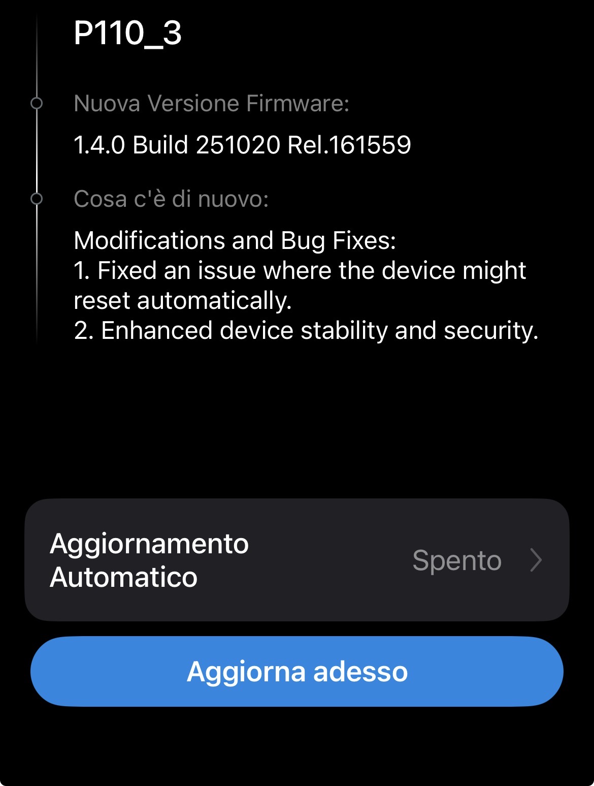

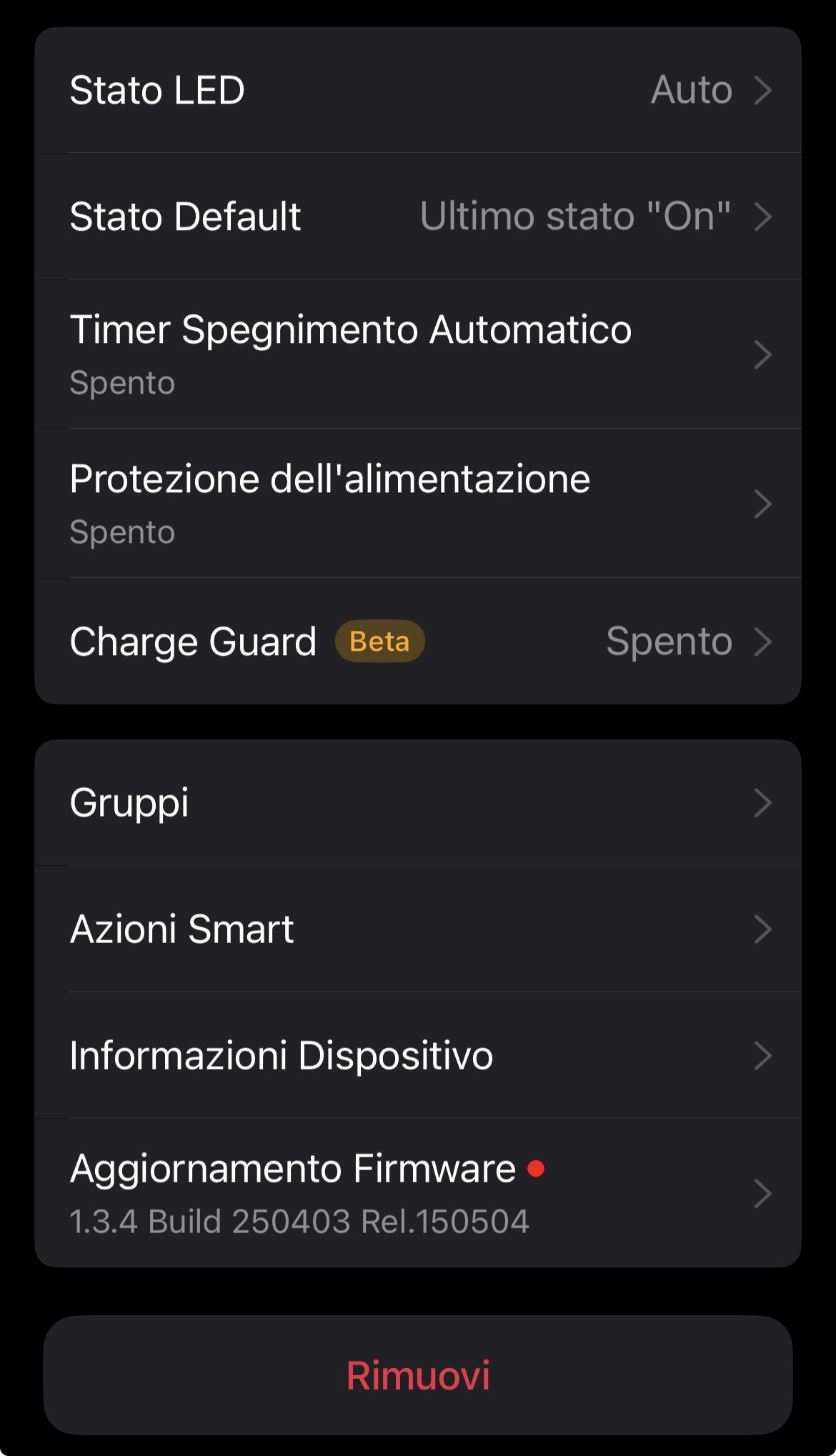

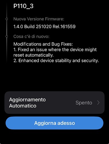

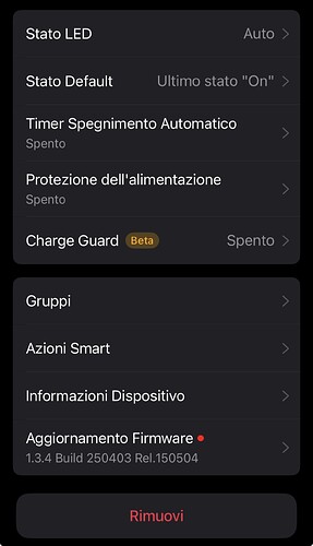

Hi everyone, I’ve noticed that among my six Tapo P110 and P115 devices, one of them suddenly stopped working with Home Assistant.
After some investigation, I realized that this specific device had automatically updated its firmware — the auto-update setting was enabled.

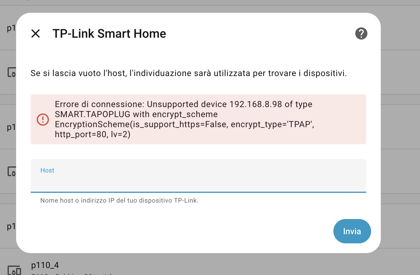

It seems the new firmware introduces the usual authentication issues that prevent proper communication with Home Assistant.
I’m attaching the connection error along with screenshots comparing the previous (working) firmware and the updated version that breaks the integration.
