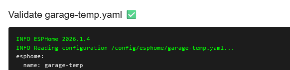

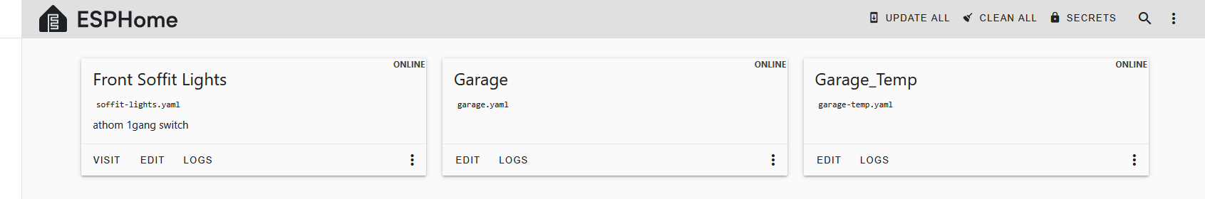

I’m hoping someone can point me in the right direction. The picture below shows the ESPHome dashboard and all three of my devices are current.
Validation for one of the devices.

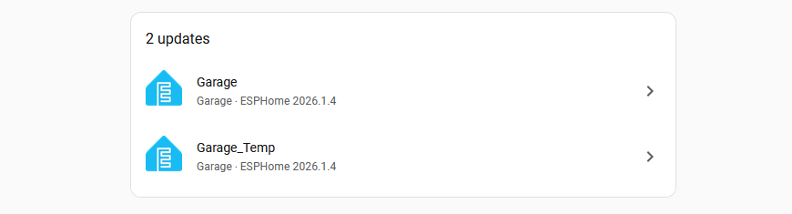

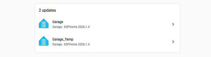

This picture shows only two devices and they both need updating:

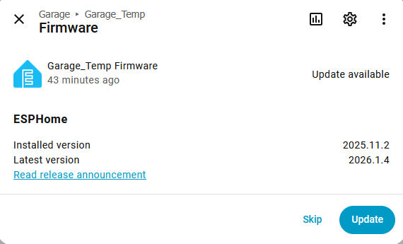

There version number it’s showing is:

  1. The ESPHome dashboard is not completely reliable regarding update status (or online status). Sometimes it takes a few minutes to show either. (I suspect the issue lies in mdns (i.e mydevice.local).
  2. “Need” updates?? If it’s working- no. You don’t need to update an ESPHome device unless there is a new feature or bug fix that you need. Otherwise turn off the device firmware entity and you will never be prompted for an update again.

  1. The ESPHome dashboard only shows the devices where there is a yaml file in config/esphome.

I think it’s that the update notifications appear before you update the firmware and aren’t automatically dismissed once you’ve updated them.
So you can “skip” them. Can’t recall if they go away after a restart.
Traditionally most new/intermediate users would manage and update via the ESPHome dashboard.
Updating via those Home Assistant notifications is a newer HA feature, and possibly a few things don’t quite sync up just yet (or may take some time as stevemann suggested).
